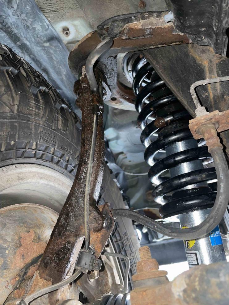

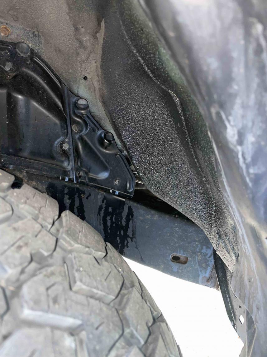

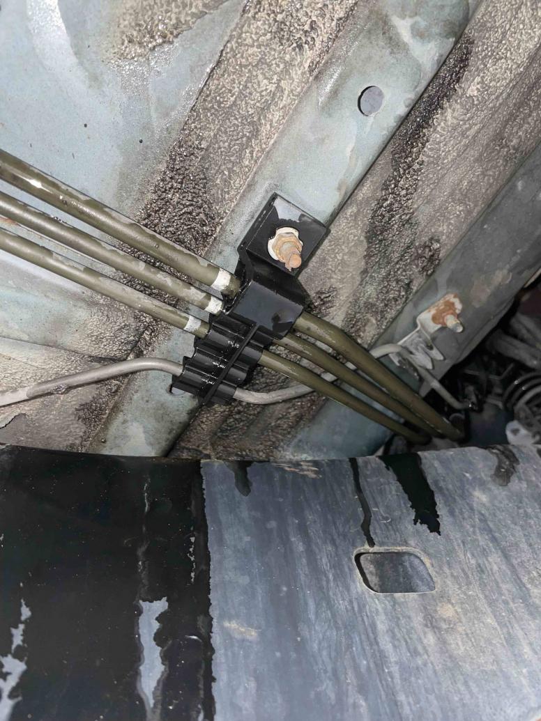

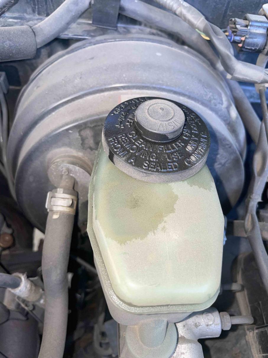

Hey all
Got my rotors and pads replaced by a shop this past Wednesday. Driven the truck a few times since but this morning on the highway, went to slow down and the brakes faded bad. Pedal goes all the way to the floor basically before it bites. Was able to make it home fine, but noticed a whole bunch of oil/grease in the drivers front wheel well and up around the brake fluid reservoir under the hood.
Is it a blown brake line? Shoddy work from the shop? Frustrating that I just got them replaced and now having issues. Any insight is appreciated, see attached photos for more.
UPDATE: After poking around here and poking around under the hood, I'm thinking this may be my same issue: Master Cylinder, Seal, or Booster
Could this be what happened to my truck? My fluid looks much the same - dark brown, and my reservoir is FULL. Haven't tried driving the truck since it happened, so I'm not sure if my braking power came back after it cooled down. And if the fluid boiled and leaked, could it have leaked on the front rotor and caused braking troubles?
Am I crazy, or is flushing the brake fluid something the shop should've done when they replaced my rotors and pads the other day?

Glad you made it to a stop safely. One of my biggest fears is brakes going out. I hope you rinsed that all off as soon as you got home brake fluid eats paint for fun. Looking at inside of your the tire it looks like it’s leaking out of the bleeder screw. But with the amount shown, maybe they tore a hole in the brake line by letting the calipers dangle as they changed pads and such. Have you identified where it came from yet? I would grab some eye pro and have a friend pump the pedal while I was looking.

Take the following with a grain of salt because I'm no brake expert! If you only had the shop do pads and rotors they should have removed the cap from the brake fluid reservoir and covered it with a rag or something and left the rest of the fluid system alone. This is done because you need to compress the caliper pistons to fit the new (thicker) pads. The fluid is forced back into the system and it has to go somewhere. They may not have removed the cap and blew it off, or they didn't use a catch rag and it overflowed. Not sure how it found it's way up front, or why they didn't notice that and clean it up when they put the cap back on, but that's my crackpot theory.
Have you compared the mystery fluid to the fluid in the brake reservoir to see if it looks, feels, smells the same?
