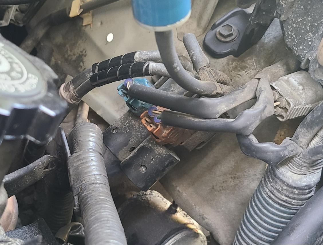

Anybody know whay these two little doodads are under the fuse box and charcoal canister?

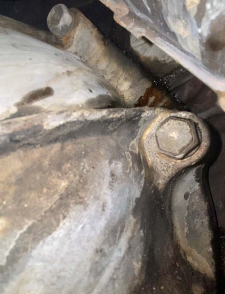

Impossible oil leak…….. experienced DIYer in need of help.
Hey guys, new member. I’m active on the Facebook group but haven’t ventured here yet. I’m in need of help with a mystery oil leak. It is running down the passenger bellhousing on the transmission from the top. Before you suggest valve covers or plugs/ moons, they’re dry. Recently did those 6 months ago and confirmed with an inspection mirror. This leak is strange, it almost looks like it’s coming out of the coolant plate on the back of the engine. The heads are dry where they meet the block. The bell housing is dry underneath in the center. It is pooling around the cross over manifold and leaking down from there. Any suggestion would be appreciated.
I would pull the lower intake manifold to get a better look at it if it's that bad.

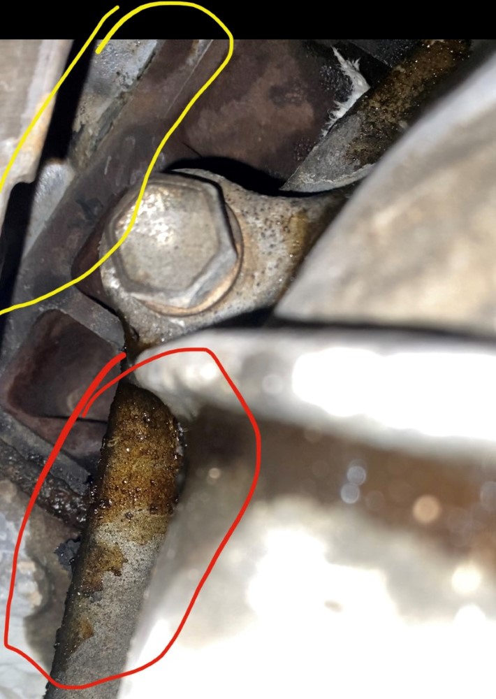

Thats what im planning on doing let me see if I can attach a picture to show you. Just to further add details, this is non-coolant. There are no freeze plugs leaking. The only thing I can think of is enough oil going through the intake to pool up in the valley and leak like that.... or worst case scenario an external head leak near the rear. This would be extremely rare lol I have not seen one documented case of an external leak of just motor oil from a 5vz yet.
Pics attached, yellow is head gasket, red is where it is originating from. You can see why this is pissing me off. Again, it is NOT the valve covers or anything associated with it, otherwise you would see the head wet too, which it is not.
