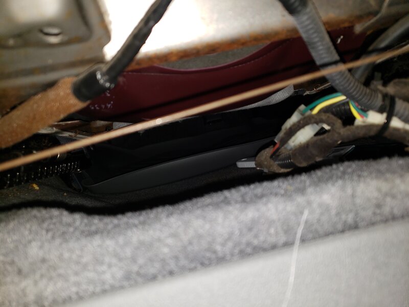

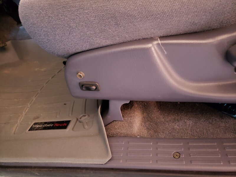

I have a 1999 4runner SR5 with the non sport seats. Per the pictures of the driver's seat, anyone know what the toggle switch on the left front side does?
Wires go from the switch to the flat brown vinyl bag pinned under the seat bottom. I've never seen this in the much more common sport seats, so I'm confused.
