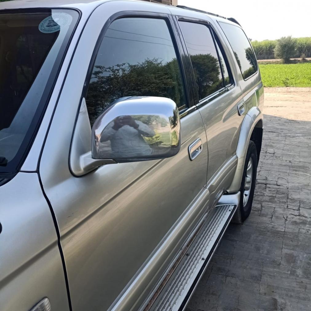

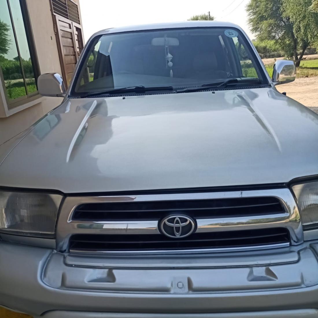

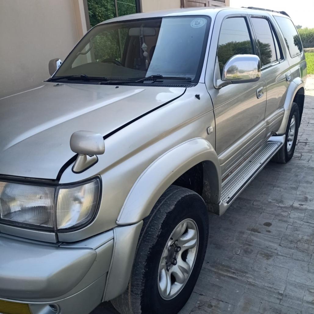

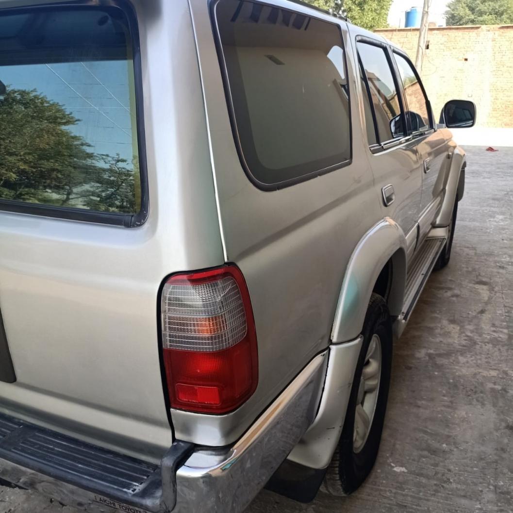

Colour Code Hlep
Hello
I want to know the correct colour code of my surf; can you guys help me

Colour Code Help Required Toyota Surf
Hello Friends;
Need help to know the correct colour code of my hilux surf; Pictures attached
Thanks in advance
