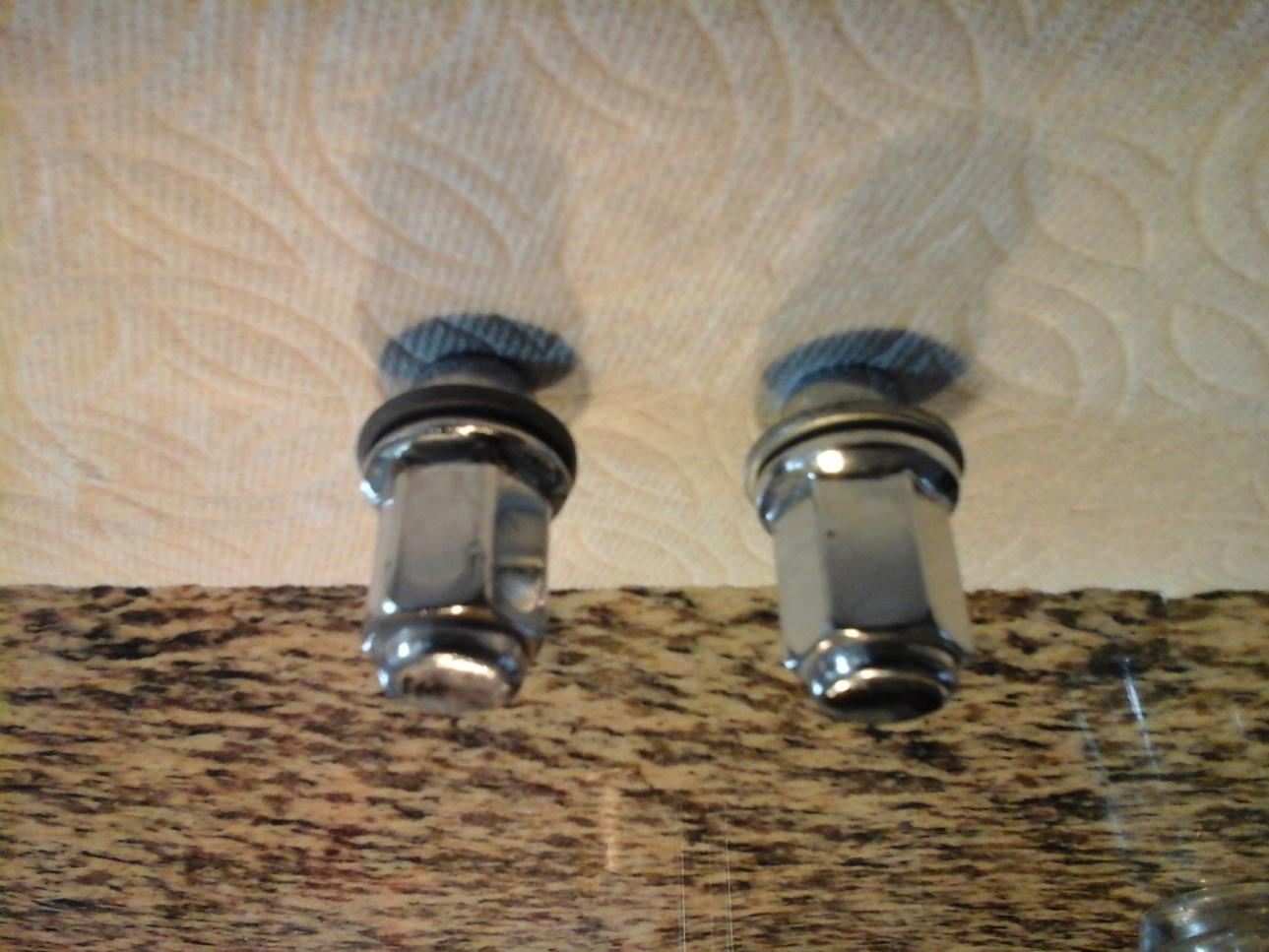

I have a '99 Limited. Planning on putting ~2020 4Runner TRD Offroad wheels on. Will I need to buy new lug nuts? (Hub-centric, lug-centric? I'm not well-versed)
Is there any other reason 2020ish wheels shouldn't fit? I saw slight differences of center bore between new and old, but I don't know if that matters.
Toyota 4Runner Wheel Specs: Lug Nut Torque, Hub Bore, Bolt Pattern & More | Sparky Express – Sparky Express Roadside Assistance
This chart, unless it is overly-simplified, makes me think I can use my (acorn style?) lug nuts putting 2020 TRD Offroad wheels on my 1999 Limited, and that everything else is the same. Anyone know definitively?
I'm not familiar with the lugs on newer models, but the OEM 3rd gens use mag style lugs. A quick search suggests that current models still use mag style lugs. If that is the case, acorn style lugs are not a substitution I would be comfortable making.
5th gen and the 3rd Gen lugs are identical. sorry about holding my tablet upside down but I put the lugs back on so it will have to do. Hope it helps.
