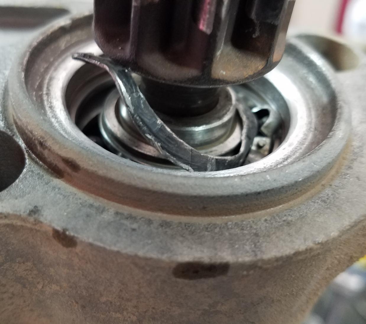

Starter issue?
Perhaps your thread can tell me. I turn the ignition key, and get a loud metal on metal grind. Just a quick bump, cuz the sound is a bit scary. I think the starter may be engaged, and that is what I'm hearing. If that's the case, is a new starter the answer, or is something else causing it? Battery is holding at 13.3, so it's good. I'm going to check the starter wire now, but I'm a DIY guy, though necessity 8s teaching me I had better learn. What do you think? Could something be causing this other than a bad starter?
Sounds like your starter is grinding on the flywheel. I had this issue a few years ago when the bearings on the front of my starter when out and allowed the bendex to move around and hangup before disengaging. I'd pull the starter and check it out. You can also have them tested for free at autozone.
