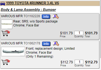

Has anyone ordered the chrome bumpers from rockauto? Wondering if they're any good/how the fitment is. Dealership wants $900CAD for the set.

Although I don’t have personal experience with these I’m pretty sure I’ve heard that they’re fine. In terms of pricing I think that’s probably worth every penny.
Been a few years for the price they a good deal, chrome nor metal as thick as OE. Mounting holes for limited trim,
to body, 3-piece rear required some enlarging for fitment.
I haven't. I bought the Certifit equivalent, and they fit fine, despite the "sortafit" reputation. I ground off the chrome, and did a heavy duty refinish in graphite on both sides. (They tend to rust out from the back. So whatever you do, address this before you install them or they won't last long.) Six years later they are just fine in salt-belt Pennsylvania.
