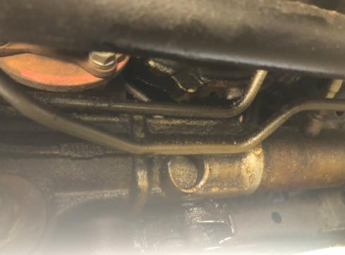

First look over my new 99 SR5 - spotted some oil behind the transmission (?). What's leaking? Will get some better photos.

if that's motor oil then based on the location it's probably rear main seal or the oil pan. it could even be just accumulated mess from regular oil changes or a leaky oil filter.
if it's not motor oil, then the type of fluid will tell you exactly whats leaking (tranny fluid, power steering, etc.). It all looks pretty much the same once it's dirty.

Thank you. Yeah I'll give it a clean off and see what accumulates. I need to pass an out of province inspection, hoping a good de-grease and clean does the job.

Could be the valve cover gasket/half moons, oil pan gasket, or rear main seal. Crawl back under with a flashlight and take a look at the back side of the heads. It's really common for the valve cover gaskets/half moons to leak all the way down and drip on the rack, skid plate, and ground.
