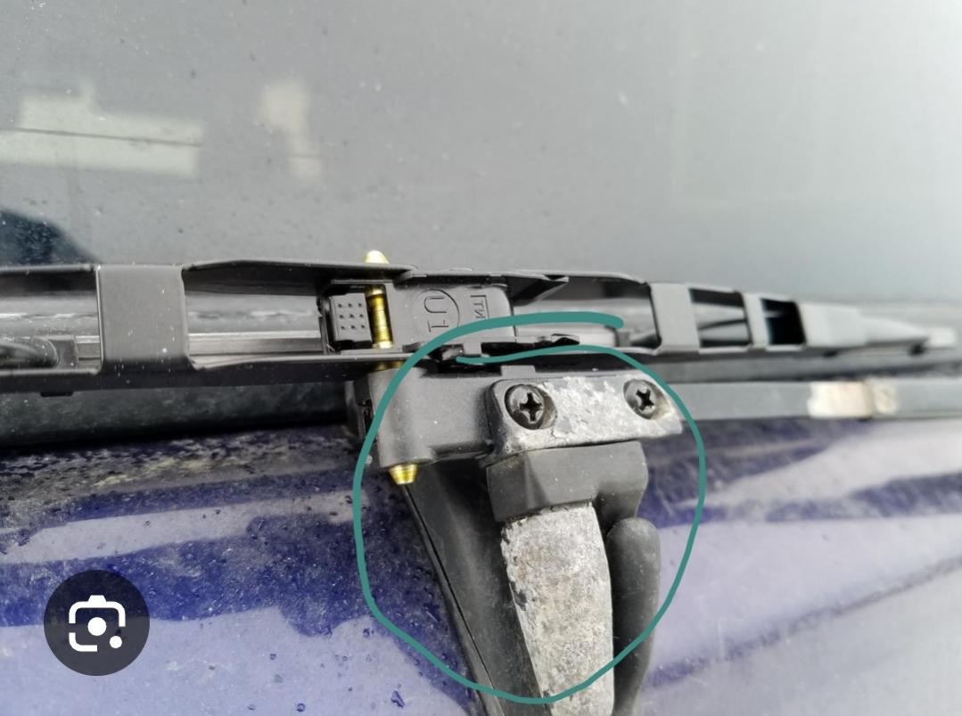

Hello!
I have a 1997 Toyota Hilux Surf (it's a 4runner with a funny name) RHD for work (I deliver mail). While delivering last night I lost the entire wiper blade and the triangle mounting unit. The arm is there, but nothing else. What is the name of the triangle part and what screws do I need to replace it? I have replacement wiper blades of course just not the part that attaches it to the arm.
I believe I attached an image of the part I need. This is my first time (and probably not last) posting here so please forgive me if I didn't.
Thank you all in advance!
