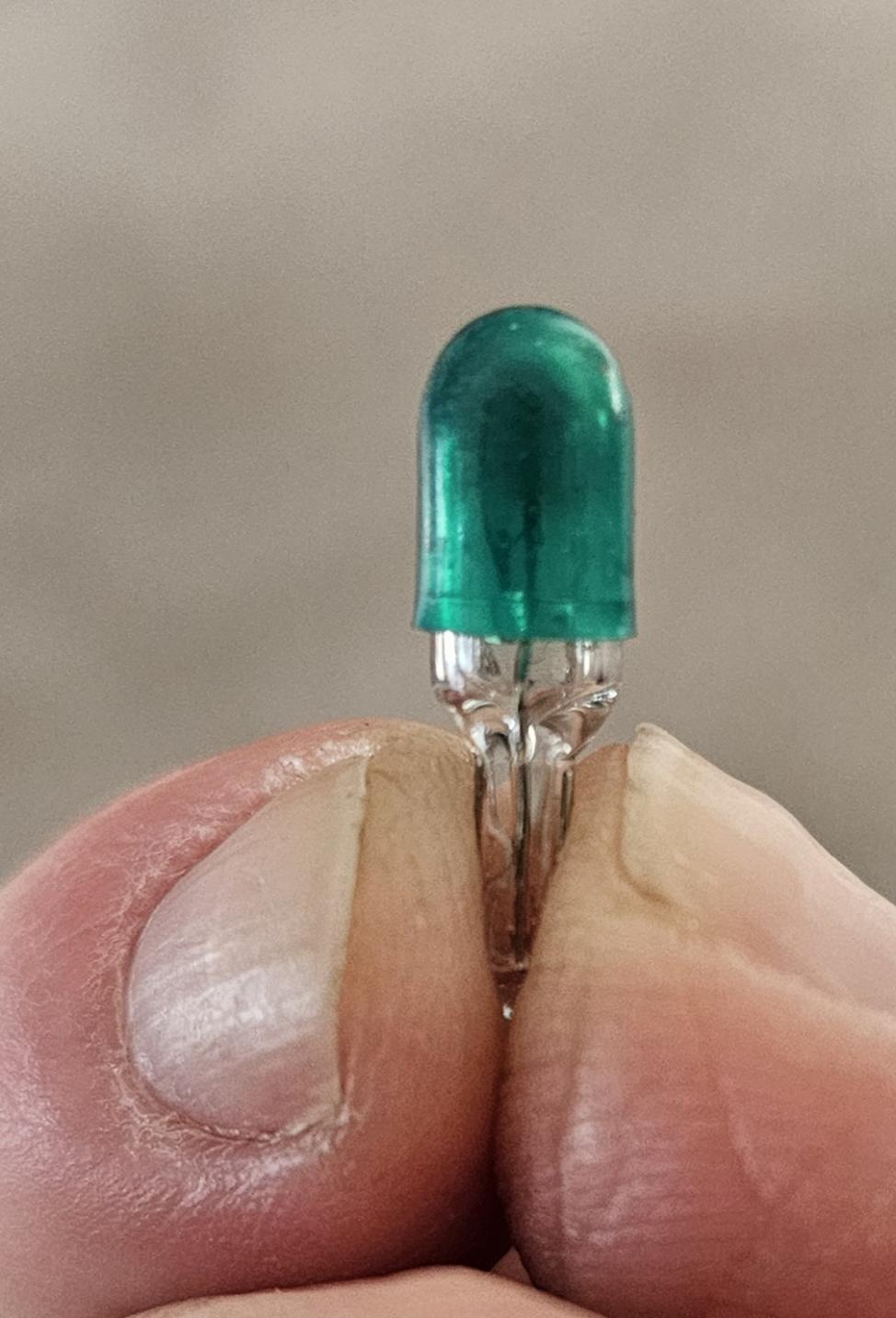

I have two TINY light bulbs that go into where the HVAC controls are. I have never seen bulbs this tiny. I can't distinguish what the letter/numbers are on them because they are too old. Does anyone know what these are called so I can find them at an auto parts store?

Toyota part number for that bulb is 90010-05152
bulbs.com with the part # [MENTION=319302]Bad Luck[/MENTION] gave. Tech support is knowledgeable prices are cheapest.
This maybe correct size CEC 1.2W 12V 0.10A Mini T1.75 Bulb | 2721 | Bulbs.com I can't remember for sure, this bulb is used else ware in dash. I'ved used a 10 pack so far.

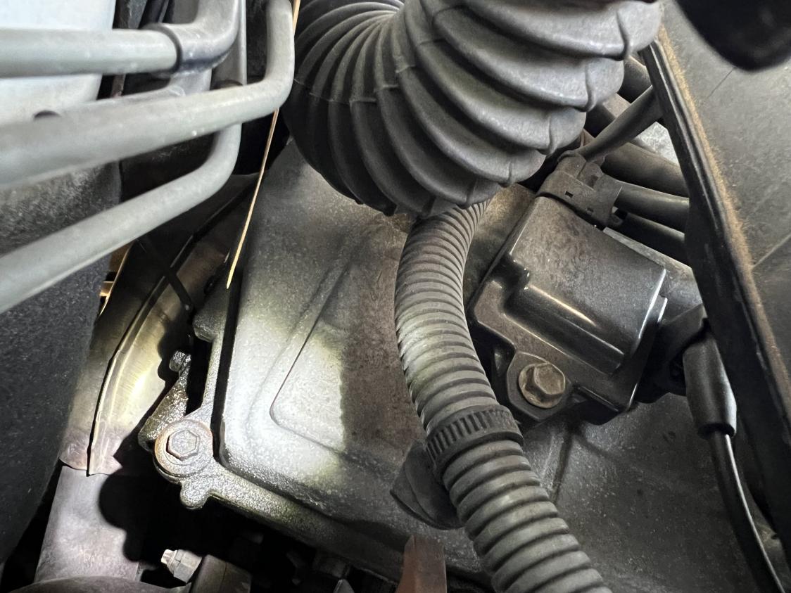

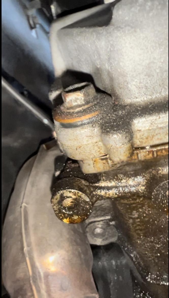

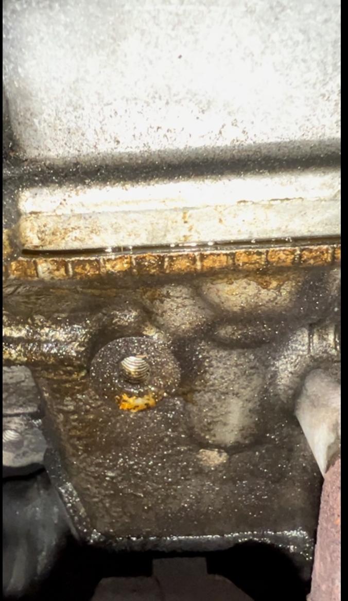

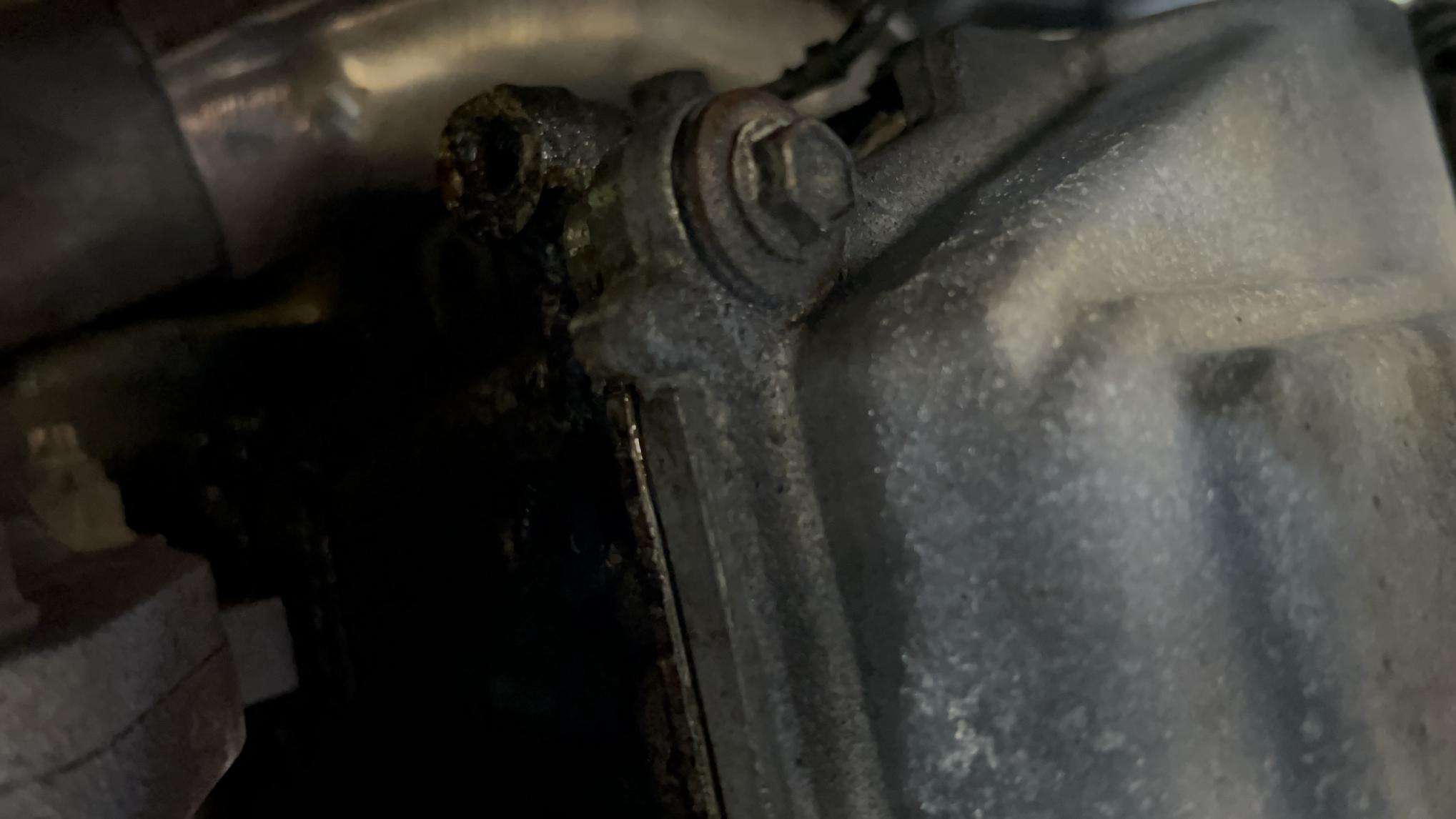

Possibly valve cover gasket?
So I got home from work today and smelled a burning smell and saw some smoke. Naturally I was like wtf. I can hear something drip and sizzle which I’m probably sure where my issue is. I noticed a faint burning smell last week running errands and didn’t smell it again until today. I will attach pictures but it’s my guess that my valve cover gaskets are going bad. This would be strange to me because the gaskets were “replaced” by my dad’s mechanic before I got it. This was in 2021. I’ve never know for gaskets to go bad that fast, maybe so, this is my first 4Runner so I have no idea. Doesn’t sound right to me. Any help will be appreciated and I’ll add pictures that hopefully help. 1999 limited V6. Couldn’t get video to load so I took some screenshots of the video. The leak seems to be at the rear of the engine closer to the fire wall.

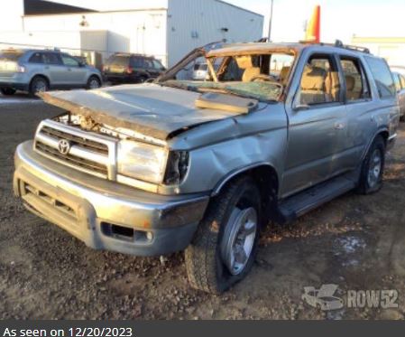

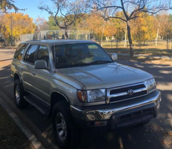

This chrome bumper from the junk yard will fit on my 99 SR5, right? Looks the same. Are limited bumpers different? Will go there tomorrow morning
