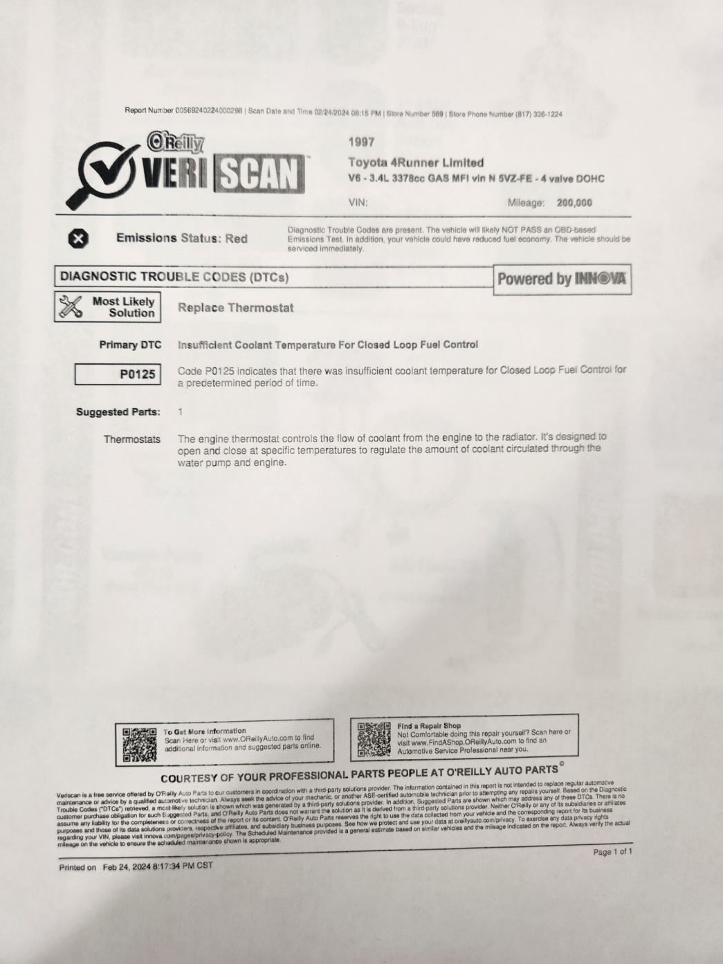

I just had a tune-up which included oil change, plugs/wires, air/fuel filters, timing belt, PCV valve, o2 sensors, etc. All of the parts were from eBay. The timing belt claimed to be OEM (and it was packaged in Toyota packaging) but I had a friend who works at Toyota install it for me and he said that it wasn't OEM.
Anyways, since the install, I have 2 issues. One of them is my CEL with code P0125 (replace thermostat), and the other is my gas mileage decreasing. I used to get steady mid 15s. Now I get low 15s, high 14s, and recently hit mid 14s. There is no difference in the way the vehicle drives, the way I drive it, the gas I put in it, where I live/drive it, etc. What could be causing this? My friend who installed it said that he had to reuse the o2 sensor gaskets and recommended I change those out for new ones. And also, the o2 sensors were eBay too.
And about the CEL, how important is this? The coolant is fine (no leaks) and temps seem to be operating as usual. Again, this did not come on until after the major tune-up, and there is no difference in the way vehicle runs. Also, I had to change my battery and the CEL remained. So a "reset" didn't fix it either.
TIA
Well, you are lucky the 5VZ is non-interference. Unless those parts came from a verified/real Toyota dealer selling parts on eBay (there are a few), then EVERYTHING you got is a knock-off and is unlikely to work as designed.
For the coolant temp CEL, get an OBD-II reader that can report live data and see what it says. It should be between 185-195*F at basically all operating conditions after warm up (3-5 minutes unless really cold).
