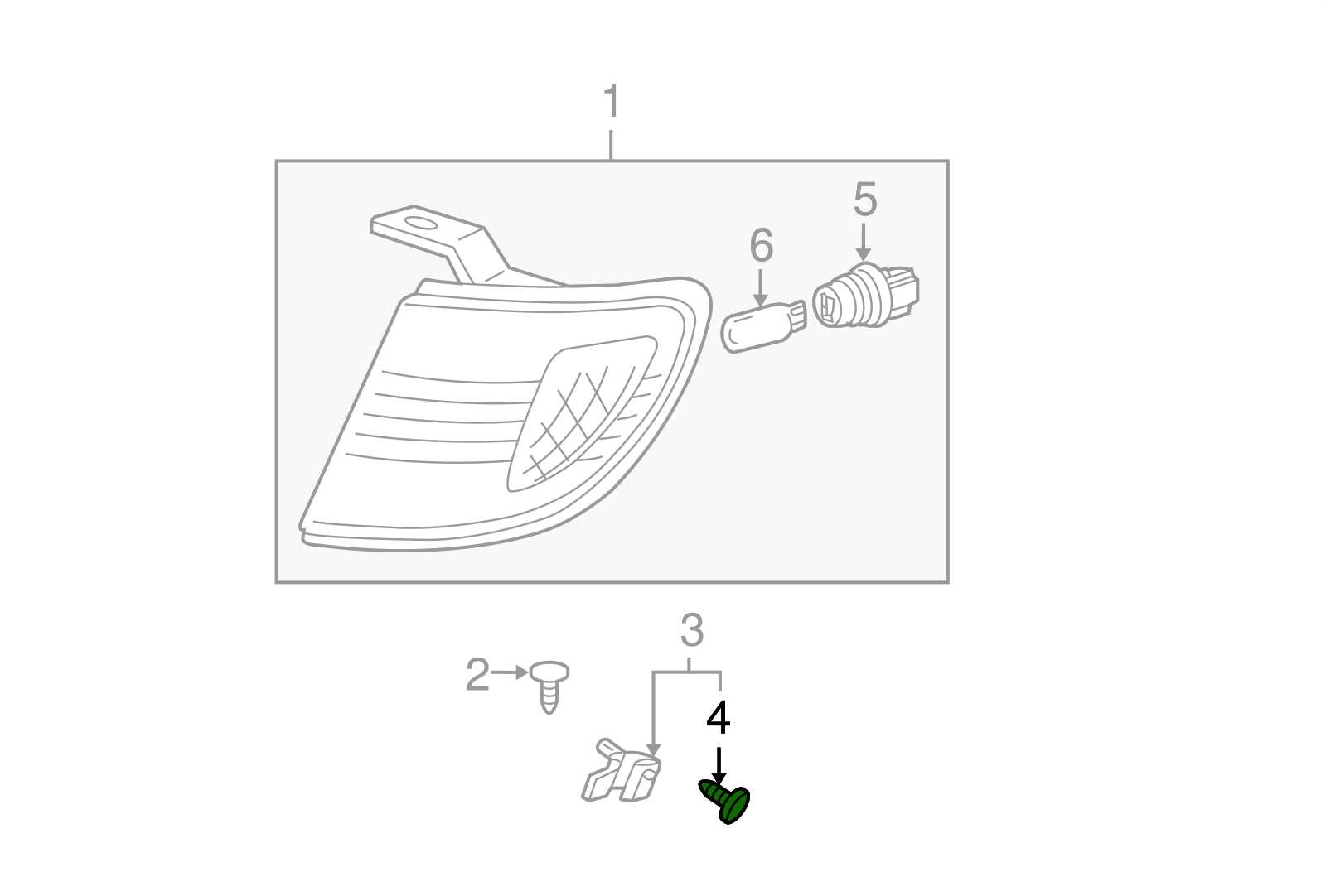

'01 Marker Light Screw Threads?
Does anyone know the thread size for part #90168-40122 ? The screws for my corner/marker lights disappeared and I need some new ones
