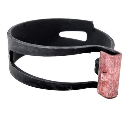

Dumb question, but does the reddish clip on the constant tension style radiator hose clamps want to slide off sideways or pop up and off?
Don't do it, 1st time using flat blade looked natural to pop it off, not, zing clang gone. :biggrin1:
More controlled event pushing to side.
I pull on those retaining clips with pliers once the clamp is in position, straight out. Usually they have a little tang that makes it easier to grab and pull:
Thanks guys. I figured the little bugger might act like a JEEEZUS! Clip when it came free. Been decades since I used a proper clamp
