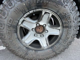

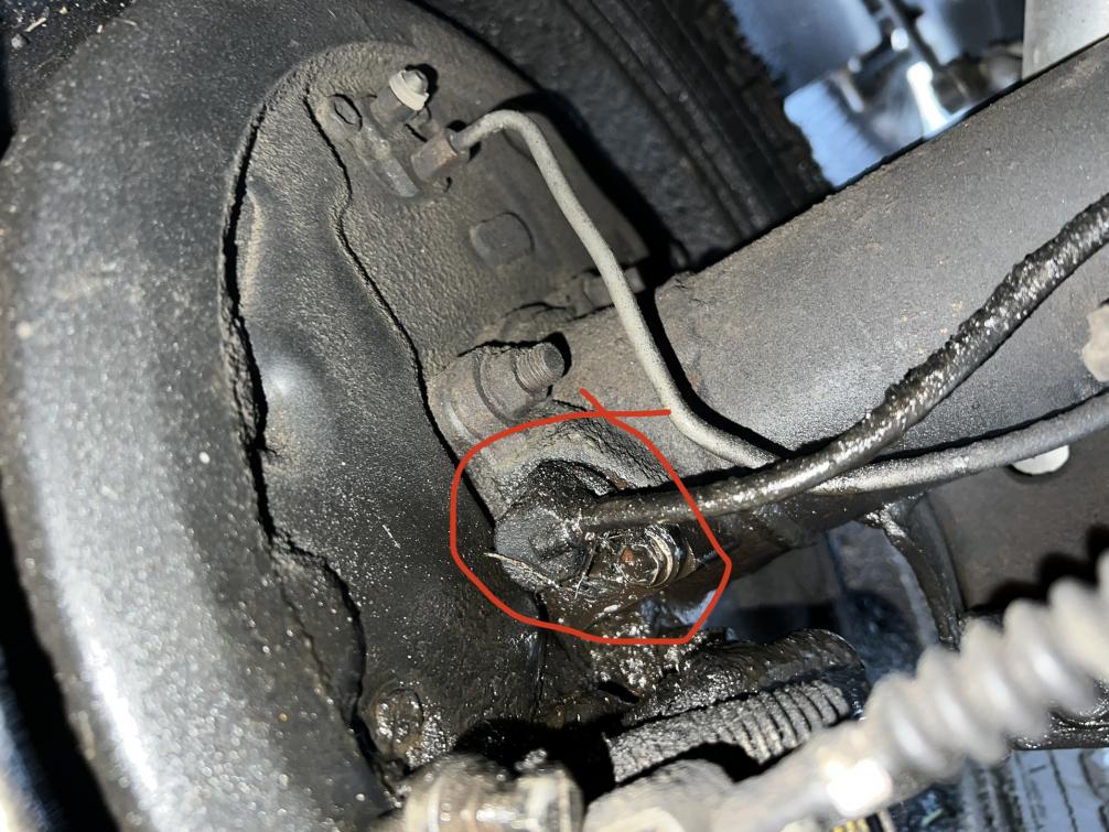

Hello all,
On a road trip back to college in the runner. Today noticed a lot of black fluid- either dif or brake all around this area on my driver rear wheel. Seems to be freshly coming from the abs speed sensor? What do you guys think… failed axle seals? Maybe something with brakes? I still need to check the breather cap and see if it’s plugged.

Hello all,
Yup, axle seal. There should be no fluid 'behind' the ABS sensor - unless the axle seal is leaking.
-Charlie
Thats a leak, pretty good one. Breather cap maybe cause.
Brakes - M/C will need fluid check it. 1st.
Depending, Diff - pull fill plug check it.
Easy answer, easy fix varies.
Rear axle seal for sure. Check diff for metal shavings as 96redrunner suggested. My experience though is that these diffs are pretty resilient though so if funds are tight you can probably get many more miles out of it. I got a pretty good deal on my '97 because it was diagnosed with a bad rear diff. I don't know the whole story but 7 years later in the CO rockies, with occasional heavy towing, the rear diff doesn't make a sound and little to no shavings show up. I wish I could say the same about my front diff. which brings me to my question.
