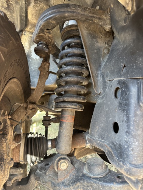

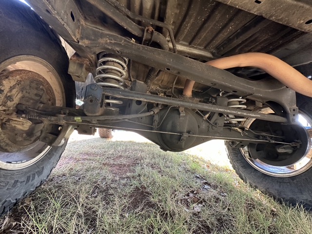

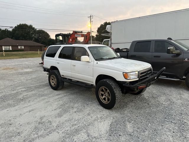

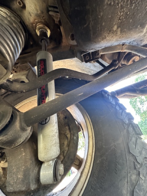

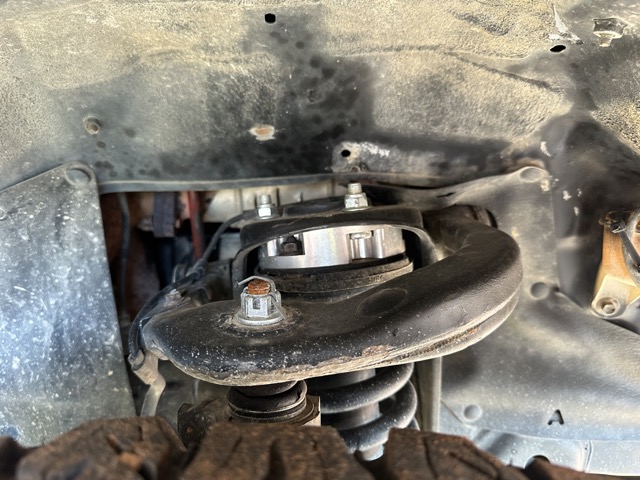

Hi folks, happy to be here. I recently purchased my dream car (1998 4Runner SR5 4WD w/ 281,000 miles). I purchased it for very cheap and so the main things I was looking out for was: Frame Rust (none), Radiator fluid (no mixing), and an engine that runs (haha). I purchased it in NW Arkansas and drove it back to OKC about 3 hours. A few things noticed on this drive: The suspension is very bouncy and it essentially undrivable above 60mph. The bounce gets too much and you could easily lose control of the vehicle if you're going too fast. One thing I noticed is if you let off the gas while its bouncing, the bouncing subsides. The suspension on this is a set of 3" lift Rough Country springs and shocks in the back (just a few years old I think), and stock struts in the front with a spacer lift on top. I think thats my issue, but I'd love to hear your thoughts. My plan is to essentially rebuild the full front suspension with a 2" strut lift as well as replacing most of the front suspension parts with OEM.
It also has a full-vehicle vibration at 55mph and above. I do believe this is due to unbalanced wheels (my rear drivers side tire is wearing unevenly on the outside of the tire).
I'm also planning on replacing most of the steering components to remove some slop, and a few other things in this order:
1. Lower Ball Joints (still stock)
2. Radiator (still stock)
3. All my drive belts and tensioners (A/C squeel)
4. Front Bumper
5. Whichever engine gasket is causing oil leak (I think its valve cover gaskets)
I am a relative newbie to this, I've never done much work on my own vehicles other than oil changes, tire rotations, replacing a few sensors, etc. Please let me know what advice you might have for me and if I should re-prioritize my list, or if I've violated any forum etiquette that I might be unaware of :tongue1:

I am not a fan of rough country lifts or the "pucks" up front. Rough country , to me rides rough. There is lots of good info on here about quality lifts.
My previous runner one was a sonoran steel 2 inch lift which I liked, current rig is only a 1 inch lift

Does the rear end feel like you are towing a 2 wheel trailer that is wobbling side to side? If so, the problem is likely the bushings in the upper and lower rear control arms are shot. I replaced all 4 rear control arms and that resolved the problem I was having. I had 265,000-ish miles on the odometer then. I couldn't keep a wheel alignment on the front a year later and had to replace the bushings on all 4 front control arms. Timmy the Toolman has great videos on replacing the bushing on the control arms, but you will need a press to get them out. 3rd Gen 4runner Bushing Replacements - YouTube That's why I opted to install new control arms instead of just replacing the bushings. Parts were expensive but I will never have to do it again. Good luck!
