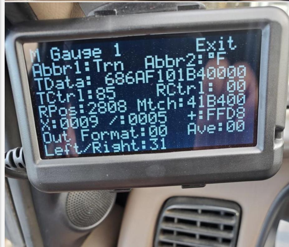

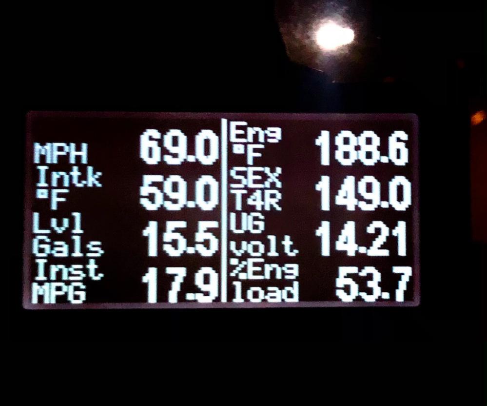

The display looks better than these crappy photos, but the SEX T4R is trans temp (you can call it whatever you want in 6 characters). The second shot is the code you input to add the gauge. There are several posts here on T4R that i used to find the codes needed to add the trans temp to the device. There are many pages of data screens on these things - this is just one layout. Some people will prefer the BT/phone app as it probably looks better. I just like the old school dedicated gauge.
  • SEX:T4R.jpg
When I got mine, the Ultragauge MX 1.4 was the one that you can add the trans temp to. It appears to be $10 more than the basic model. Still, the prices have actually dropped since i got mine - what a world!
Thanks so much, that was going to be my next question what the programming was.
Looking at the ordering site now. Which preprogramming do I go with? I'm guessing Tacoma but want to make sure. Thanks
