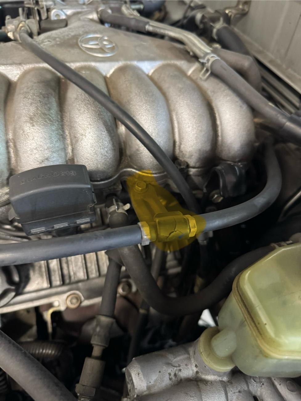

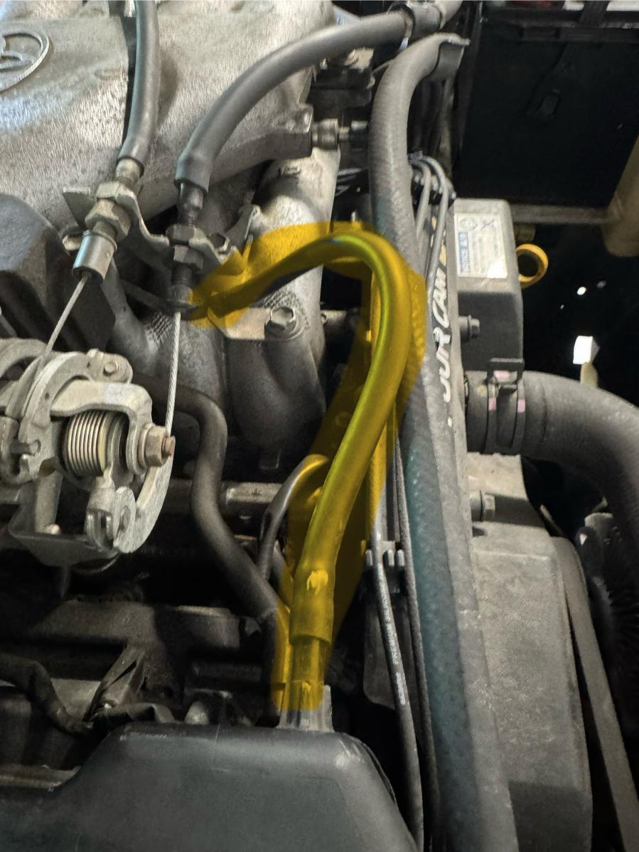

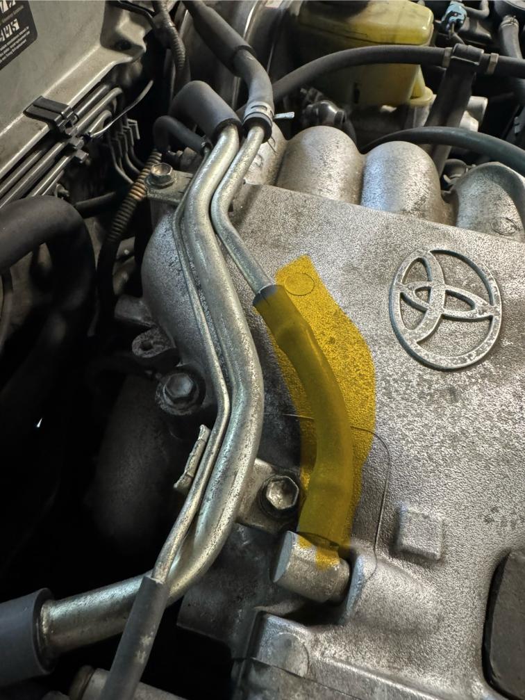

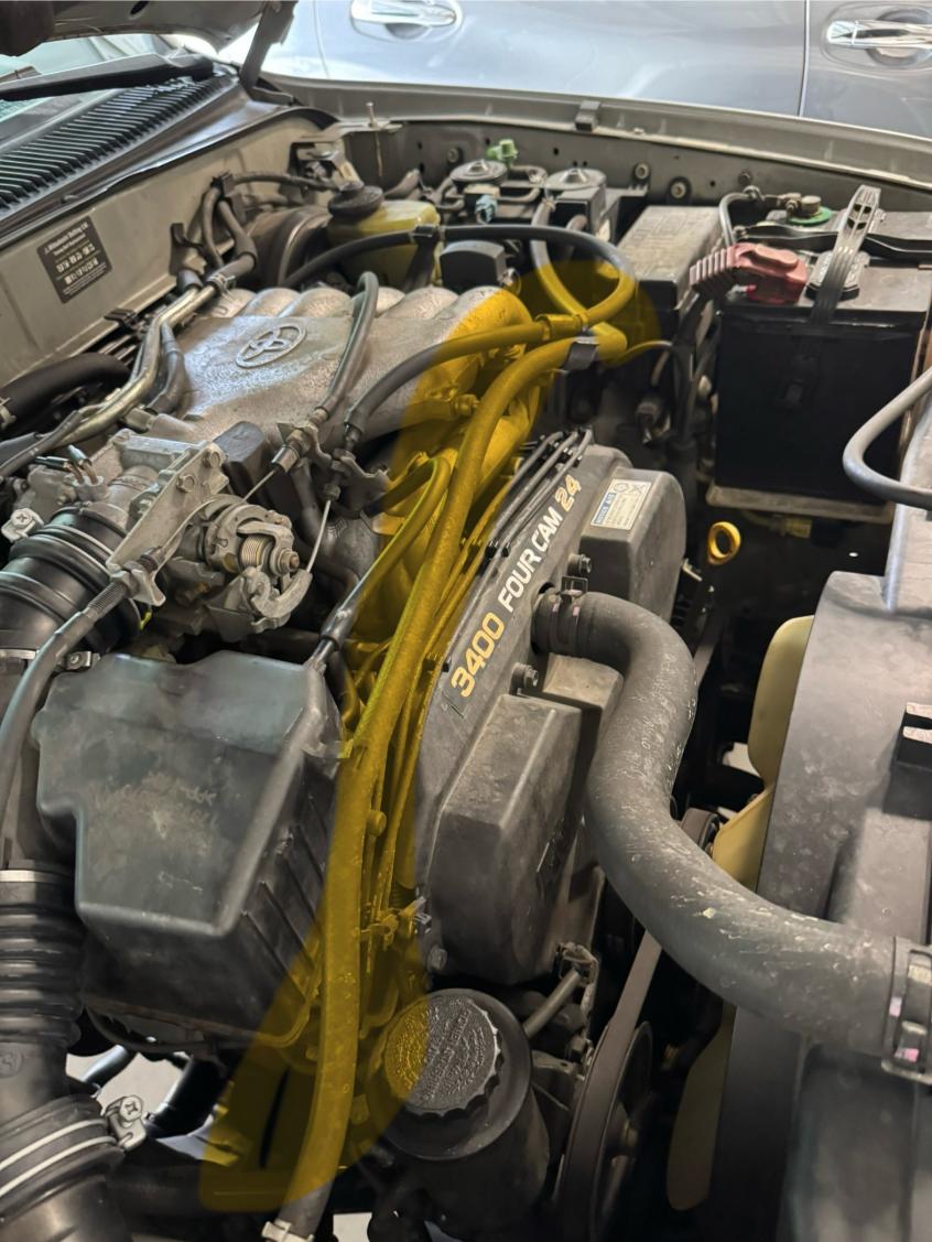

Help!
Please help me identify the names of these parts. I dont need to know what they are for, i just need to replace them. Especially the clips that are on the engine. please help.
