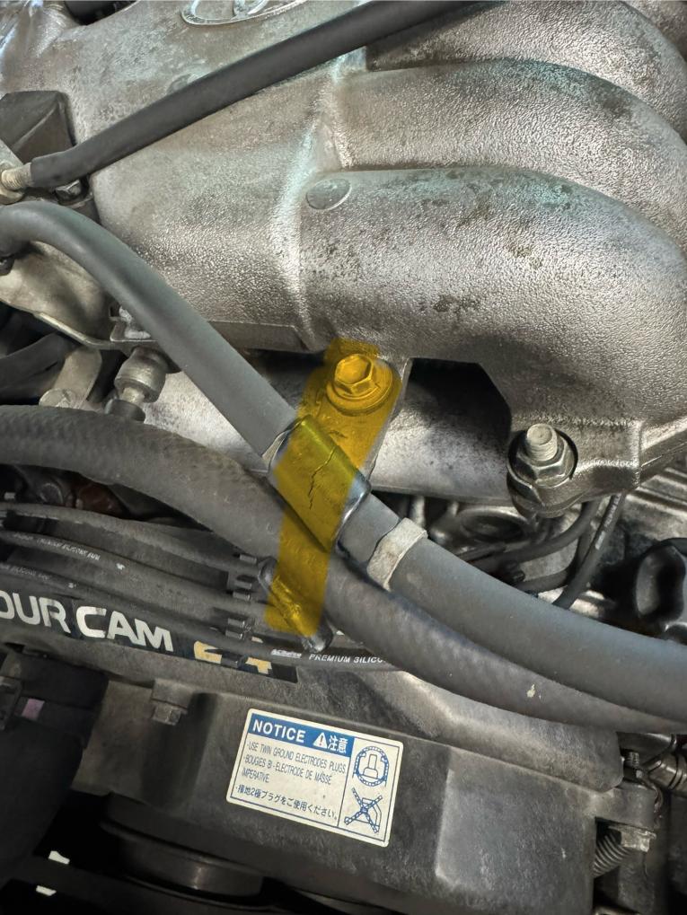

well shoot... and no replacement? any tips what to do?
Definitely trying to be proactive replacing old hoses, etc.
Used or make your own. A "P" clip with a rubber liner will work for the front of the manifold. A bent flat bar of aluminum will work for the other (with a few holes and some zip ties).
-Charlie
