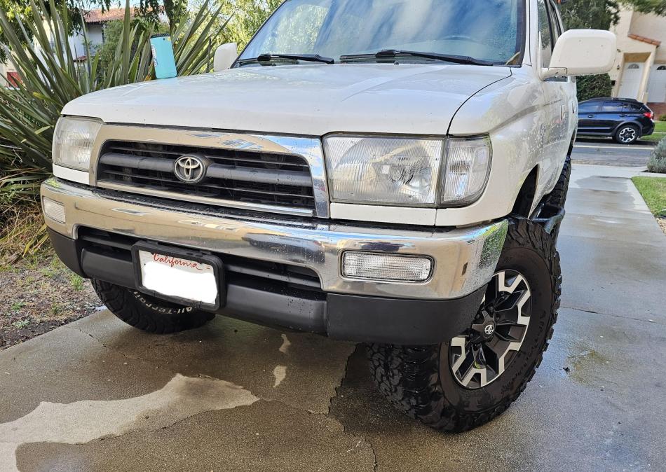

I have searching for a kit for my 2001 SR5. But I keep on finding them for older years. For example like this:
I want to remove the fat lip. But still have valance.
I cannot understand what you want to do. The lower plastic section of the bumper (valence) is attached to the upper chrome (or painted metal) section of the bumper, which then bolts to the 4Runner.
Do you want a non-fat-lip bumper? That is a fairly easy swap...

Looking for this
Credit goes to: rommelvfx on reddit

Looking for this
Right. You just need a complete '96-'98 Front bumper. Remove your current bumper and crash bar (and maybe mount plates? not sure). Bolt on the 'new' old bumper. '96-'98 had no crash bar at the front of the frame, adding it is why the bumper got 'fat' - to make room.
None of the parts between the two are compatible except for the mounting locations, so you need the complete unit.
-Charlie
Any chance you can send link me the parts i need?
Here are the part numbers.
I just replaced mine because of a little accident and decided to go with aftermarket parts because I was having trouble sourcing a clean original one. It was a pain in the ass to source all the parts and assemble, recommend getting a used one if you can. Ended up being $500 in parts, but you might not need as much I had to replace. I can provide more help if you do want to go the aftermarket route.

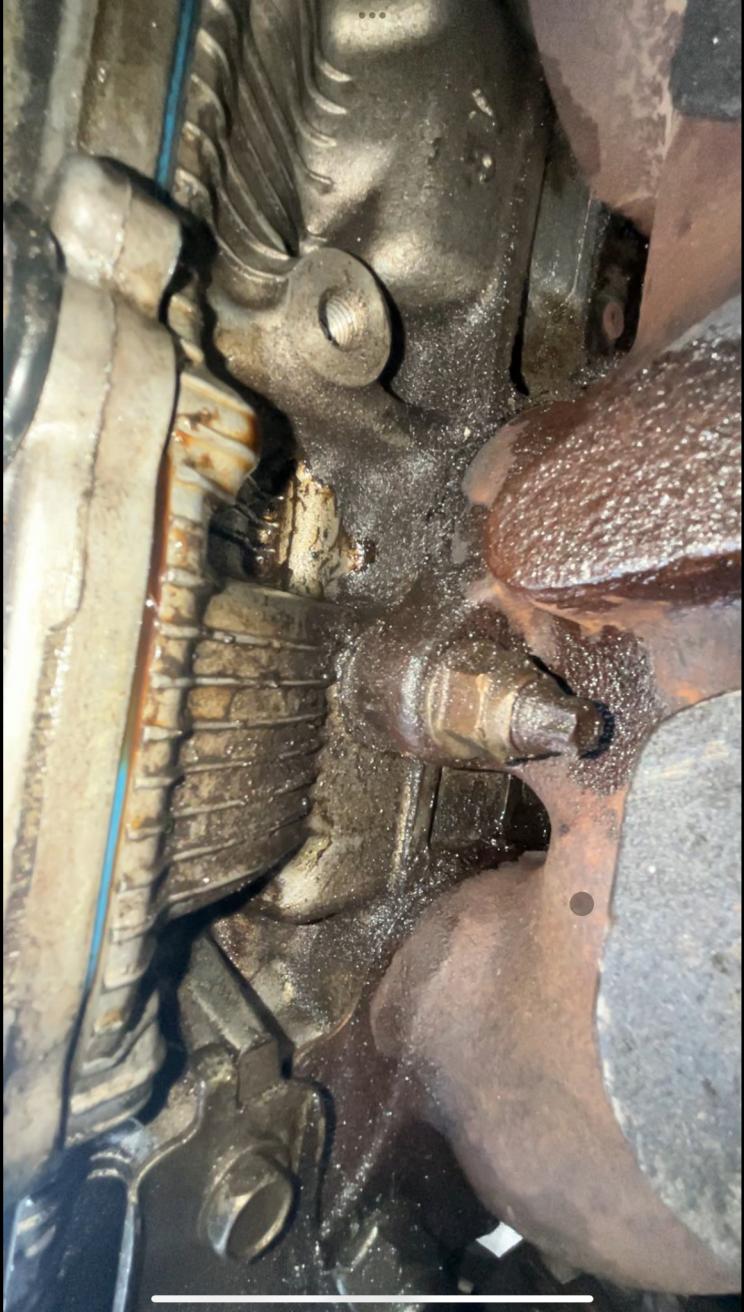

i have a 2000 4Runner sr5, my engine used to leak due to a failed valve cover gasket, it wasn’t leaking for a little then I got a smell of a slight leak.
Currently there is a little on just the drivers side so was looking if anyone has any ideas

looks like its a non oem gasket, wonder if that can be part of the issue
