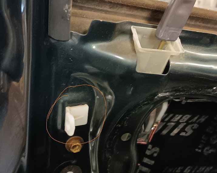

Question about Door Panel Part Number
I took my interior door panels off on my 96 to put some sound deadener in the doors and ended up breaking a few plastic parts. I am trying to figure out what this part number is or at least what this part is called. It's the part that clips into the door that the retainer clip goes into. Any help would be appreciated.
