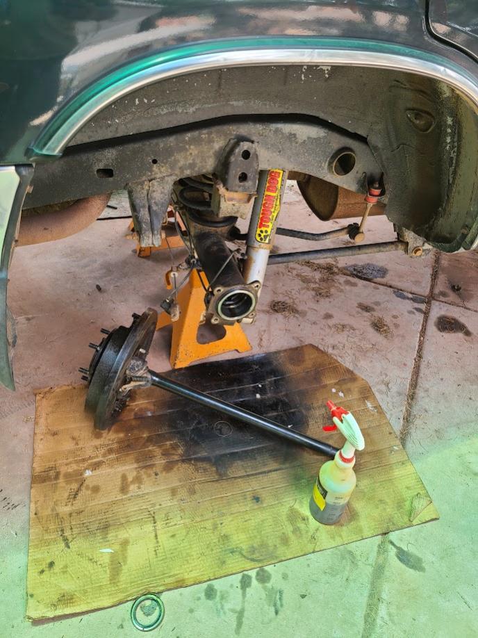

I've barely done any research as this is new to me knowledge as of this morning, but evidently my 01 needs new rear axle seals. briefly read a writeup BFAD wrote about 15 years ago but just perused over it. to anyone who has done theirs recently, is it worth doing the job yourself or would I be better off having Toyota/independent shop do the work? my truck failed its state inspection this morning, thats how I found out.
watch timmys video on it...but yes you will need some special tools and a press., or take axles out yourself and take to a shop
but in my area, I would not trust any of the shops....well maybe one...then again I have all the tools

I've since watched it and I'm definitely dreading this... next week I will take it over to a buddy's house and crawl up underneath it and poke around. If I can stretch this out until next January at least I'd be able to get it registered as an antique. Regardless, the work needs to get done. I'm fortunate enough that I have another reliable means of transportation thankfully. Weighing my options at the moment though.
If my 19 yo daughter can do it, so can YOU! The axle "tube" seal lives in the axle housing. When you remove your axle with the hub + brake + etc as one unit, the seal will become visible. Take a look at the pic and you'll see what I mean. This to me is an easy job because you're not taking apart the bearing. Am I missing something here?
