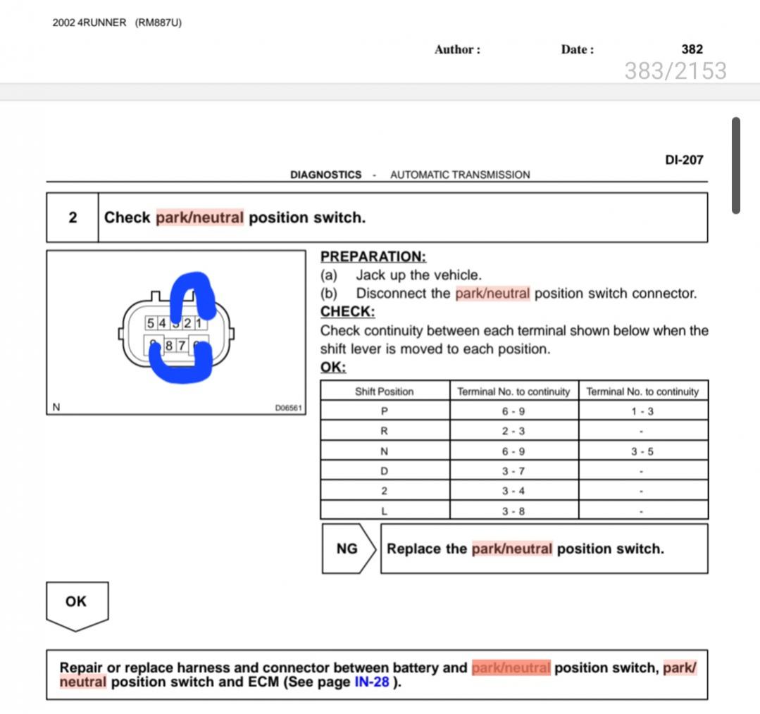

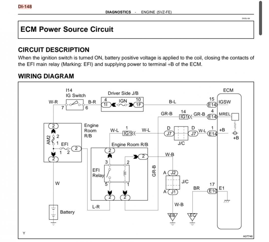

Was taking the newly acquired 2002 4Runner out for a quick trip and it flat out died backing out of the drive. DTC’s that popped up were C1207 (P/R Range switch) and C1242 (IG1/IG2 Power source circuit). After month of checking and trying things, we do not get any DTC’s on a scan now which is a bummer as I am now running blind.
Here are the symptoms and checks (that I can remember) in particular order I have done..
- Engine cranks in park and neutral (can’t be a switch issue if it cranks right?)
- Battery terminals are clean and tight
- Fuel pressure is 46lbs going to the engine
- No spark at any of the plugs
- Replaced plugs / coils / wires
- Tried a newly flashed and tested ECM
- Tried a different igniter
- Verified many check points at the ECU for voltage or ground as appropriate per the FSM
- Checked ground quality at all three engine bay points
- Replaced all fuses for ignition and injectors
- Swapped relays that pertain to the ignition circuit / injectors / fuel
- Verified that the crank and cam sensors ohm out as they should
- Verified that the wires for the crank and cam sensors are not open or grounded. Good continuity to the ECU
- Verified power and ground at the igniter module are correct
- Verified the IG2 Circuit is good.
So running blind w/o any codes. I highly doubt a shop can help me with the problem. It has to be something simple but am not finding it. I have learned a bunch so far about this truck but there’s more to learn apparently.
Any help or suggestions are greatly appreciated.

You'd be correct, no ECU relay on these 3rd Gens. I attached a wiring diagram reference for you, I imagine they are referring to the EFI relay. What I would do personally is bypass the EFI relay by using 2 spade connectors connected with a wire to act as a jumper, and jump the 2 larger EFI relay pins to test that. You would be correct about the NSS causing a no crank, but you can bypass that as well and eliminate that as a cause pretty easily. I attached a picture of the pins that I would jumper together, you would unplug the NSS connector and jump them on the connector itself. Theres also a continuity test you can do for the switch itself to eliminate that as a concern. Only reason I bring that up is the fault code specifically for the PNP/NSS (Park/Neutral Position Switch / Neutral Safety Switch, same thing AFAIK)
I would also check whether the GAUGE fuse is getting power from the IG1 switch, easy way to check is to key on car off, press cruise control switch and see if the light comes on. If yes then IG1 is powered, if no then trace back the FSM wiring diagram from there. Also, check if the ABS/Trac/etc lights come on and stay on with the key in various positions, could get some useful info from that.
Also, check all your fuses with a trusted meter for continuty, since a good deal of them can cause a no start issue, great resource if you've never used it is: 2002 Toyota 4Runner fuse box diagram - StartMyCar
Has a detailed diagram for each fuse plus brief descriptions. Main ones Id really check are EFI, visually check or remove and test the all JCASE style fuses, speficially AM1/AM2, OBD fuse, ETCS, STA, IGN, ECU-IG.

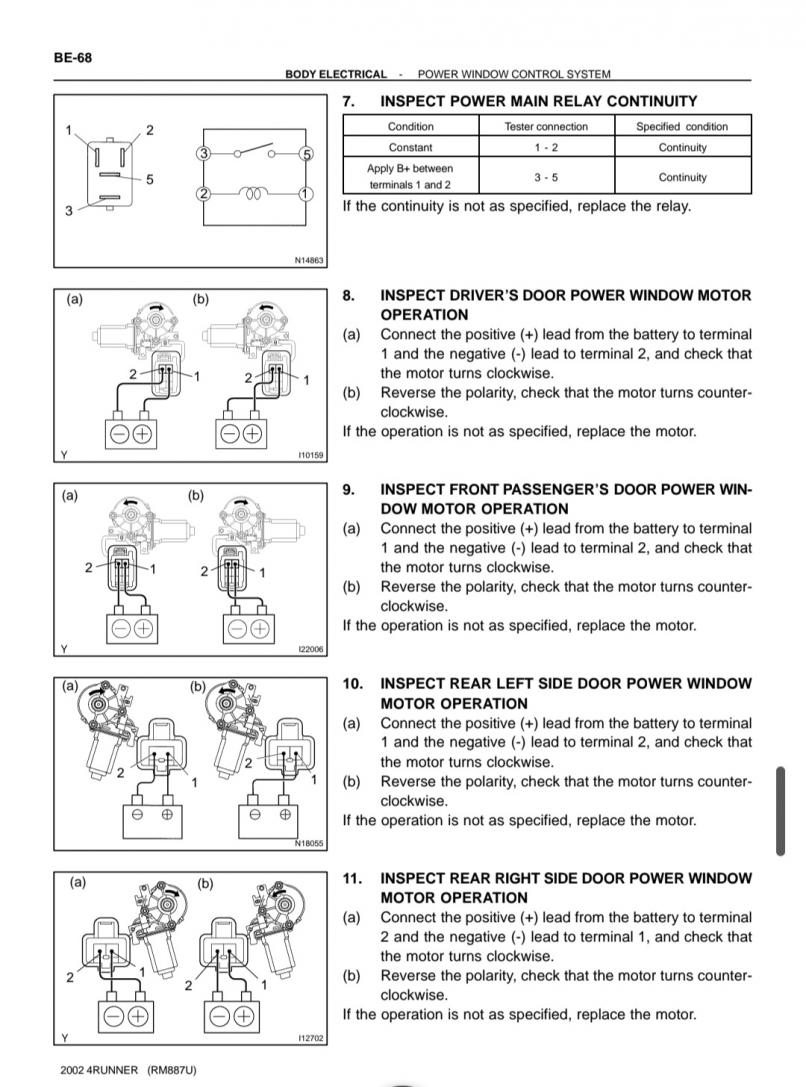

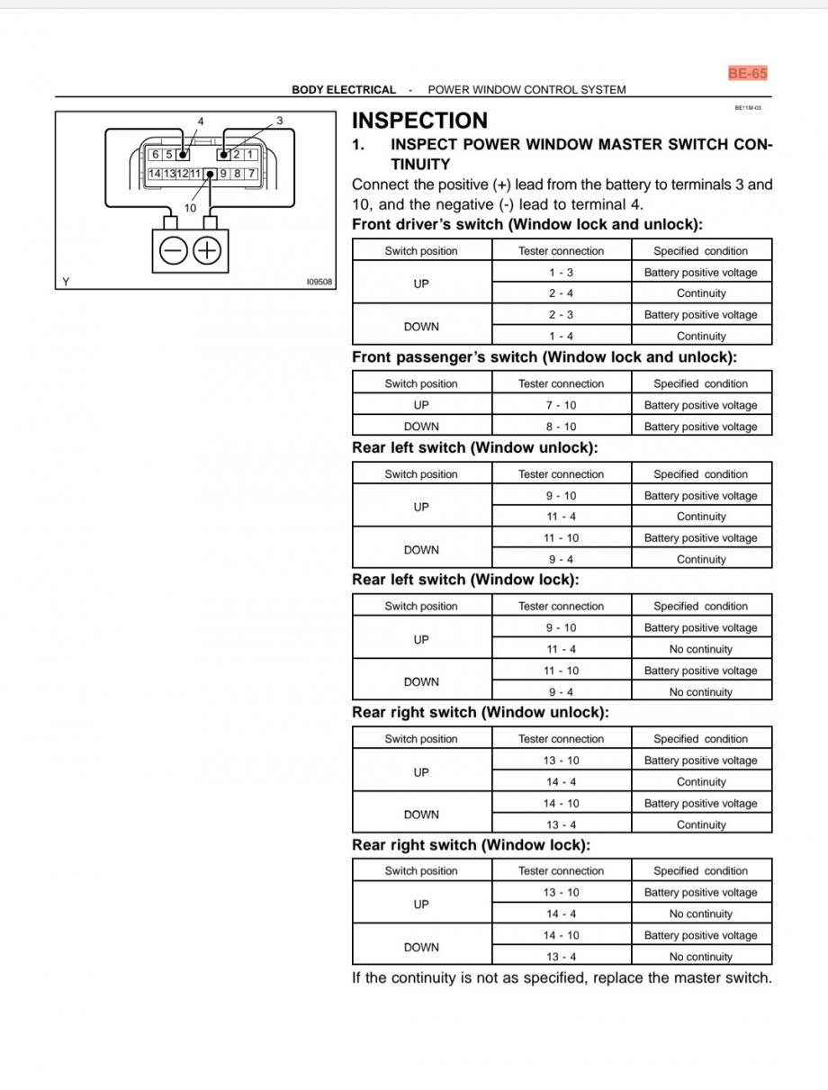

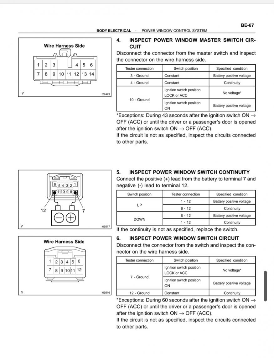

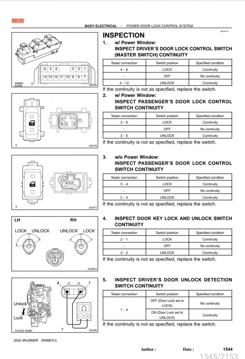

2) Driver's side window and door lock buttons don't work. Well, the window one works about 50% of the time for opening and (so far) 100% of the time for closing. Feels kinda loose/worn out. The door lock button does not work at all, but the passenger and key fob buttons work to actuate the locks.
Heres a page from the FSM you can try looking into if you have a multimeter handy, you pop out the window switch and check the connector for continuty under specific actions to check if its working correctly with locks. As for the windows, they are a bit more complicated, looks like they require sourcing 12v power to the switch to test it for some reason, but pages are attached. Good luck!
As for wanting to learn more about these vehicles, I can't recommend Timmy the Toolman on youtube more than enough as a starting point for almost any and every repair on these trucks. Also, there is a copy of the FSM (Factory service manual) floating around on the internet you can download, a website called charm.li also has a less convienent but still usable format of it too. The FSM has almost all the specific information you'll ever need for keeping it factory :)
Photos attached here for window switch testing, can't edit them into the post :/

Problem partially found...
Thanks again for the ideas. I haven't been able to shake the thought of being able to actually test the cam and crankshaft sensors so spent some time digging into that. I found a video where the mechanic did a cam to crank correlation with a scope. This helped me begin to think about testing with an analog meter. I can't find the link right now but did find a reference to measuring AC voltage on 2V range looking for something around 200mV. The cam sensor will generate a higher voltage based on the correlation video I referenced earlier.
https://www.youtube.com/watch?si=E8ERV8h7a8JpFqK5&v=rjtvFEUWyMk&feature=youtu.be
My meter only went down to 10V range so not able to be as precise as I wanted but I was getting a decent pulse on the analog meter while checking the cam sensor so that seems to be good. The crank sensor was not registering any voltage at all. Not even a tiny bump. It should have been a smaller signal but still noticeable on an analog meter.
Went and got a new crankshaft position sensor, removed the old one and found it to be damaged. There was a good amount of metal shavings on the sensor and I can see some just inside the sensor hole so looks like the project has shifted into something else.
Note for myself...
Reluctor gear is what passes the sensor to generate a pulse.
Not sure how the sensor could have gotten damaged that way. Will have to dig deeper to see what else may be damaged. Need to figure out what to remove to be able to properly inspect inside and clean up / repair .
Thank you so much!

For the window and lock switches, I popped out the controls as you said just to take a look. I idiotically left my multi-meter about an hour away at my boat (another rabbit holse style project...), so I wasn't able to check continuity of the switches. Are the individual switches replaceable? The driver's side window button is almost springy in its housing compared to the other three, and the lock button locks but does not unlock. There are screws to take the control further apart, but I think it is more likely I will break the working switches than fix the broken ones, or am I overthinking it?
