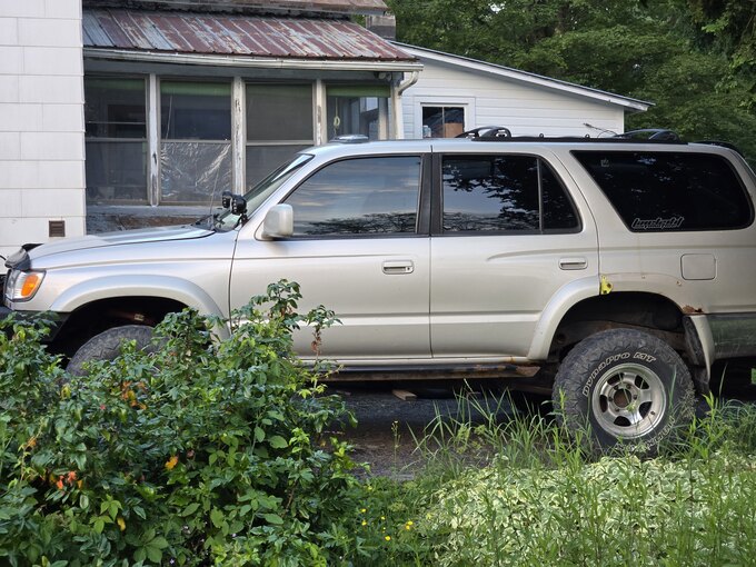

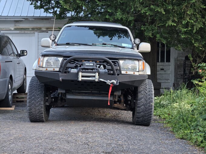

Hey all,
I recently bought a 2000 4runner with a lift that was installed back in 2015. Lift details: Front coils are from a 2004 Tundra TRD. Front and back shocks are the Bilstein 5100s. The rear coils are from a 1995 FZJ-80 Land Cruiser.
My issue is the front is noticeably lower than the back with the front drivers side an inch lower than the passenger side. The drivers side tire is rubbing a ton when you turn left. The front coils don't look broken but the front shocks look like they're leaking.
What do you guys recommend? Do I buy new 5100s and rebuild the front assembly using the 2004 Tundra coils? I would love to put the 33s I bought with it on it, but they would rub right now due to the front end sag. Also, there is a steel bumper with winch on the front as well as a steel skid plate adding additional weight.
Thanks!
