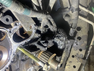

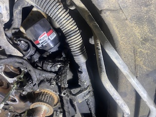

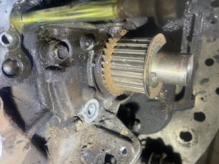

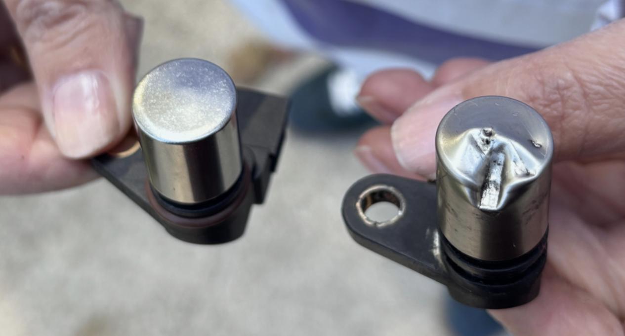

Just following up on a couple of previous posts relating to my 2002 SR5 that would crank but not start. After a ton of research and troubleshooting she is running again.
The root cause was that the timing belt tensioner pivot bolt backed out and the washer that sits between the tensioner and block fell down into the crankshaft timing gear. The washer hit the crankshaft sensor surface not allowing it to sense any of the passing teeth from the reluctor. Since the crankshaft sensor was not sending pulses to the ECU, no spark was the result.
I took the opportunity to do the timing belt replacement with water pump, cam and crank seals since everything was apart. In good fashion, I got to put the timing belt on twice as I was off by one tooth on my first try. The crank gear alignment of the belt got me.
So a few thing to pass along to anyone who may be interested from learning from my mistakes...
- A "newly rebuilt" ECU is not guaranteed to work, even with everything in good shape. I had to switch back to the original ECU before it would run.
- A full physical inspection of sensors is necessary. Just because it meters out fine doesn't mean it is good. Mine measured the right ohms but had a smashed face.
- Follow the data and just don't throw parts at a problem. I started to get impatient and it just cost me more time and money.
- When you are doing work that will be covered up when you finish, take a lot of pictures to reference later to answer the questions... "did I do this or what did that look like?".

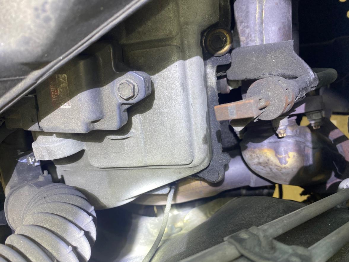

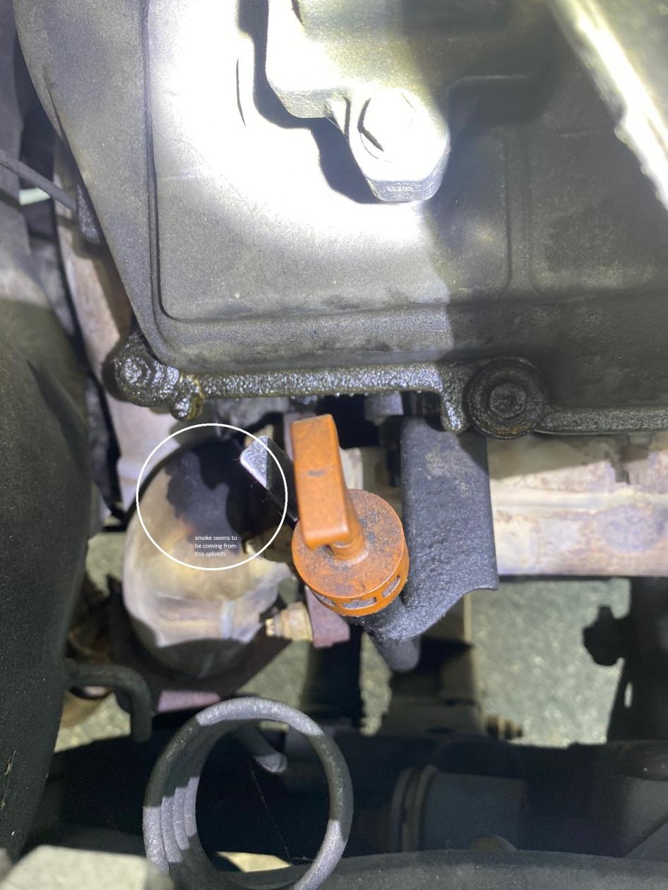

Hi everyone, I'm a newbie here but a long-time 4Runner owner, but also an absolute novice in terms of engine repair. I'm hoping to get some advice about white smoke coming from the engine. It appears to be coming from a black substance (oil?) burning when the engine heats up. There also appears to be a decent amount of oil or something residue buildup on the engine block itself. I've compared it to my other 2001 4Runner which does not smoke, and the smoking one does 'look' worse. Obviously my concern is whether this is likely a blown head gasket. I've attached pictures of both the smoking and non-smoking vehicles, with the smoking part circled. The pictures are taken from the passenger side looking down at the back passenger side corner/side of the engine. Not sure why one is rotated 90 degrees. Any thoughts would be appreciated! -Kevin
That looks like a leaking valve cover gasket, very common on these trucks. Oil dripping onto the hot exhaust manifold, hence the smoke.
Thanks for the reply. I scrubbed it clean and it doesn't smoke now, of course, but I guess we'll see how long it takes for it to build up again. I'll take it in unless replacing the valve cover gasket is easy DIY. Does the oil buildup along the engine (above the splotch, on the bolts etc) look normal or is it indicating of a head gasket issue? I'm not seeing the same gunk on the other 4Runner.
The built up oil on the bolt area is from the leaking valve cover, nothing to do with a head gasket, the bolts are what is securing the valve cover!
Involved, but not hard DIY. Look up the Timmy the Toolman video on the 5vz valve cover gasket replacement on YouTube.

Also, where do you think this oil buildup is coming from?

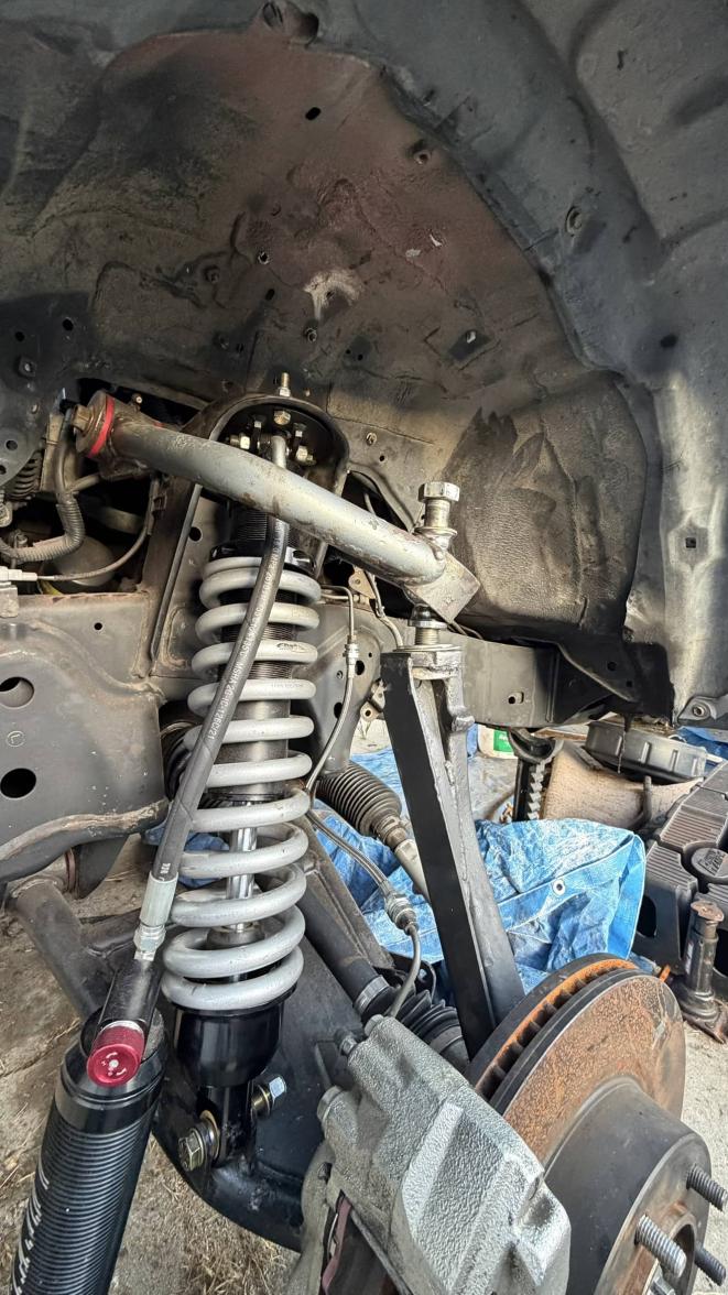

Long story short, im installing a long travel kit (total chaos’ first gen tubular kit for 3g4r and 1g tacoma).
Im having a really tough time aligning this uca bolt to the spindle, its trying to go in crooked and i dont want to damage the nylon locking nut or puck provided by TCF. Ive reached th maximum amount the bolt/uniball wants to articulate to get into the puck.
Ignore the welding of the puck i had some play in it and decided to firm it up, and im almost certain this didn't warp the spindle/puck.
-Ive tried jacking down the UCA with a bottle jack a good bit and it still seems to be going in slightly crooked but better.
-Ive also made sure the extended axles(oem axles for tundra +3inchs) are seated properly in the diff so they arent binding.
-Also ive tried jacking up the lower control arm but i just end up lifting the vehicle.
-I know someone may say to take the coilover(standard locked offroad 2.5x8in with eibach 550lb spring) out while i do this but if i do that then i cannot get the coilover back in.
Kinda at my wits end going in circles with this install, any help would be much appreciated especially if you have experience with long travel kits on these cars. For reference the passenger side went easier, still similar issues but for some reason that side managed to go in smoother.

You have the L and R upper control arms on the wrong sides.
