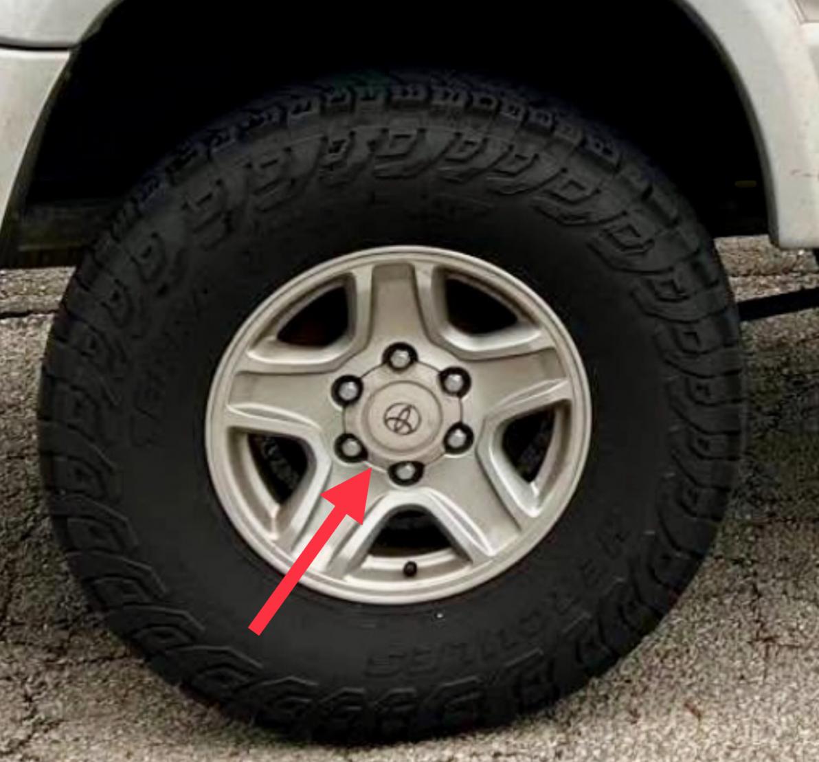

New to the platform as a ‘99 w/252k mi. just joined our ‘05 Land Cruiser and ‘08 FJ.
Quick question: on the way home, a wheel center cap went AWOL. Are the 6-spoke caps the same as the 5-spoke caps? Is there a reliable place to source these?

42603-35630 : 42603-04030 check out these part numbers tpd had them for around $25 not really sure if that is a good price. I'd also check the inside of one of the remaining caps for a part #

Not cheap from Toyota but here's a link, I would suggest finding one at a salvage yard, or you might find one on eBay!!
42603-35630 Genuine Toyota Wheel Hub Ornament Sub-Assembly)
Edit: Also found this, much cheaper for the part, but the shipping is crazy, not sure if they are OEM or not but they appear to be.
Toyota :: 42603-35630 ORNAMENT SUB-ASSY, WHEEL HUB

Wheel Cap Paint color?
The wheels on my recently purchased 3rd Gen look great but the paint on the wheel caps is toast. What’s the best or closest color match to the color of the factory wheels? Pic for reference.
