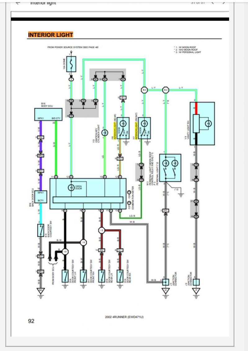

I cleaned everything but the same problem persists. Light works with ON setting but not with DOOR (even when other systems in the truck tell me that the doors are open).
The power to the dome light is constant.'The door switch grounds when the door is opened activating the light. Check the wiring in the door loom and the switch.

This is very helpful. Thanks! Is this system on a special fuse? Both the front and rear dome lights have the same problem.
The dome fuse is key off power for radio, antenna, combination meter etc. The fuse is located in the engine fuse box.
