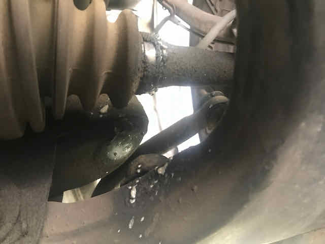

I saw this on the driver's side today before replacing my front sway bar bushings. It's the first time I've noticed any grease being flung about like that. Am I looking at a bad CV axle, reboot, something entirely different?
Torn cv boot. You can reboot those or get replacement axles. Timmy has a good youtube video for rebooting the stock axles and stretching the boots so they don't rub: CV Axle Reboot & Replacement With CV Boot Stretch Mod - YouTube Part numbers and torque values are in the video description.
I watched that video last night and it looks like I could muddle my way through it after buying a couple more tools. I should've known better than to try and clean anything! Probably tore it myself while wiping. Guess that's to expected at 25 years.
It's pretty common for axle boots to start leaking after any change in ride height. They spent the last 200k miles used to a certain ride height and don't like the change.
There was no change in ride height. The only suspension change I made before this appeared was replacing LBJs. Either way, it's old. I'll have to get to both sides after I do the brakes and rack bushings. Funny how everything was "fine" until I got it in my head to wrench on this thing myself!
