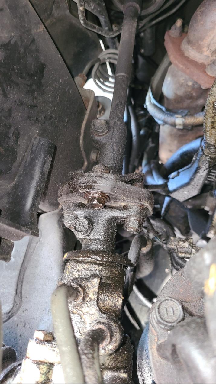

1) anybody know what this part of the power steering is? It's the culprit of my leak and I'm curious what involves fixing it. I assume there to be a gasket of sorts that's gone
2) if that's not feasible without replacing the rack, could I potentially use ATF with stop leak to hold off for the time being?

Where exactly do you think it is leaking from? How sure are you that leak is coming from the power steering? From what I can see, it looks like you have fluid above the high point of the rack.
Right where the shiny spot stops at that bolt/flange. Pretty certain its coming from there, I have a valve cover leak too that was making the rack dirty but I also noticed a constant, slow loss of PS fluid (ATF) too - so I cleaned and dried everything, and after a day or two I found a drip leading back up to the flange pictured. Color is hard to tell since it gets dirty but seems to be reddish.
No fluid runs up that high. I'd be looking for something above that point dripping down.

I had a leak that look similar to that on my 4runner. I found the leak was coming from the rubber piece area with yellow paint mark below the flange. Its part of the rack and pinion. I was not able to find any repair kits for it at the time. I ended up replacing the rack and pinion. I never tried adding any type of stop leak. Hope this helps.
Looked like this when my driver side valve cover was leaking. Check bolt torque
Thanks, I'm thinking I'll start with my valve covers and see if anything changes. I can see directly above the flange is some oil and how it could technically drip down. Probably better to eliminate one thing at a time anyways
