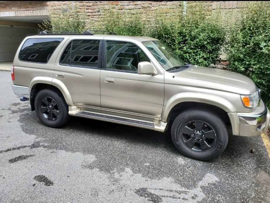

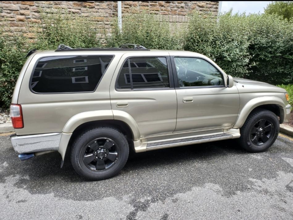

May as well post here... My newly-acquired 2002 4runner sr5 (yet has factory leather/chrome, go figure!)
The wheels are Toyota (4th gen, I believe; crudely painted black, I know...) 17 inchers with 265/65r17 Kumho Crugen all-season.
My question is... Will 255/75r17 fit without any rubbing up/down? I believe, yes.
No rubbing as she sits now (highway mostly, with some beach driving, no off-road flexing stuff). And appears to have more than enough room to add an inch or two of diameter.
The new size would be narrower than present, so the only increase would be EVER so slightly in overall diameter.
I'm thinking it'd be no problem, but what say you fine folks?
Thanks!

I'm no expert but roughly calculated, the bigger size is about +1.5" in diameter and about .5" narrower, so you could visually add about .75" to the current tire where it comes closest to the fender/well while cycling lock-to-lock to get an idea of fit. Shouldn't have any UCA/spring clearance issues as you said. I'm not sure how to pre-calculate rubbing under suspension compression, however, but you say you don't expect to flex much. Not sure how you be able to resist hitting some trails though.......
Easily!! Closest legal/public land trails are 3hrs from home :(
Thanks for the reply!
