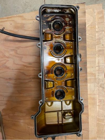

burnt oil on valve cover
I'm doing a valve check on my 3rz and there is burnt oil around the top of cylinder #4 on the valve cover. How can I diagnose this? any help troubleshooting this is appreciated!
Some one with a 3rz might have a better idea.( [MENTION=148218]JZiggy[/MENTION]) but my guess wood be valve not closing fully. also a valve guide leaking. A valve adjustment should help.
