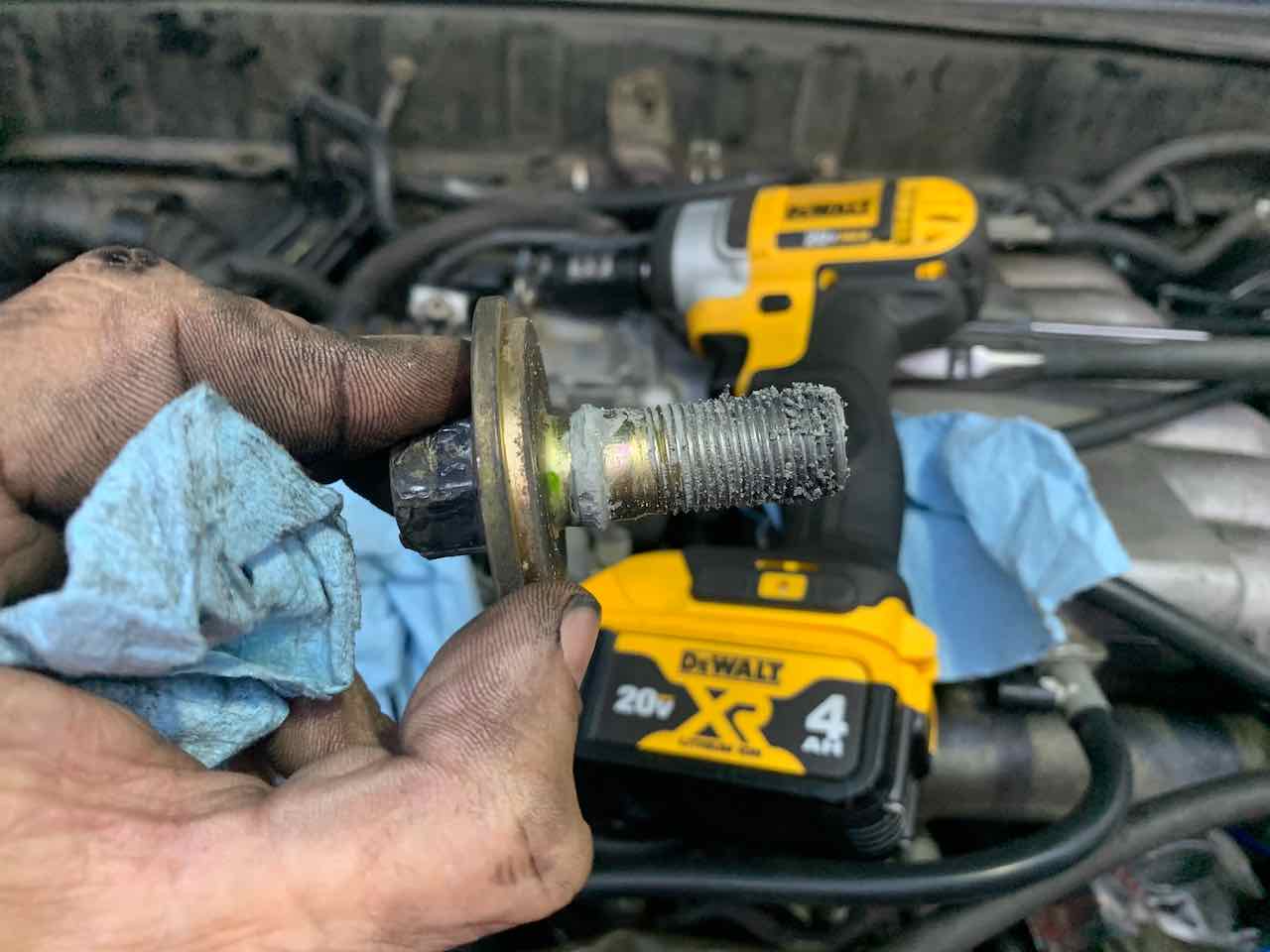

Anyone think it's possible a DeWalt DCF880HM2 impact could remove a properly torqued crank bolt? It's my understanding this thing only goes up to 150lbs, maybe a little more on breakaway.
All I know for sure is it won't budge my front diff drain plug but it didn't hesitate with the crank bolt when I tried it out of curiosity today. Out in 3 or 4 seconds. I'm guessing that just means the guy who did my timing belt job last April didn't put any muscle into it.
Come to think of it, this thing sometimes hesitates with lug nuts and that's only 85lbs.
That crank bolt was definitely not tightened enough from the previous guy. My 1/2 IR2235 impact took a couple seconds of hammering to get the crank bolt to move.
