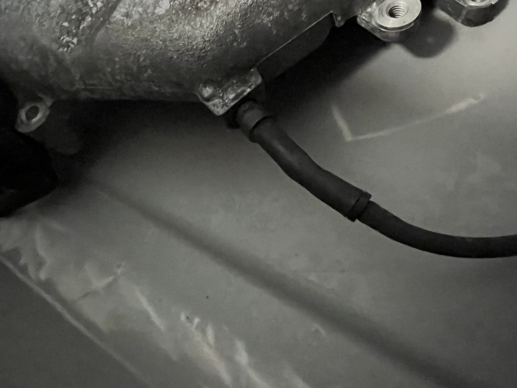

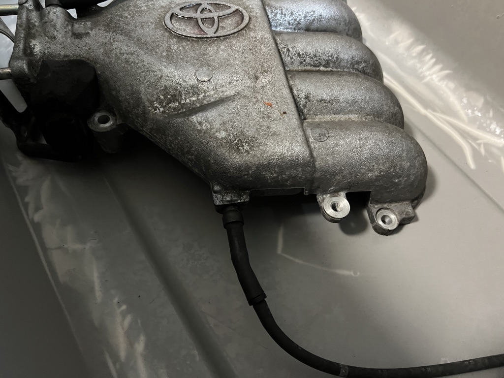

Soooo I'm doing my valve cover gaskets, etc. I got everything off, and I'm about to deep clean the plenum and valve covers. This hose is giving me trouble on the upper plenum. It also doesn't look quite like the other hoses, so I'm hesitant to yank harder in an attempt to remove it. It appears to have a plastic fitting in the hose or something (see second image).
Question: How do I remove this? Yank harder?
BUMP!
Going to tackle this today and hopefully apply some new aluminum colored engine paint on the valve covers and plenums. Shameless bump in hopes someone knows the answer :)

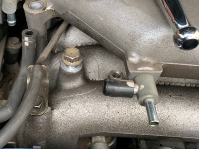

Is that some sort of clamp on the end of that hose? If you can't pry it off, maybe cut it off and replace it. It's just a vacuum hose.
My '96 looks different.
