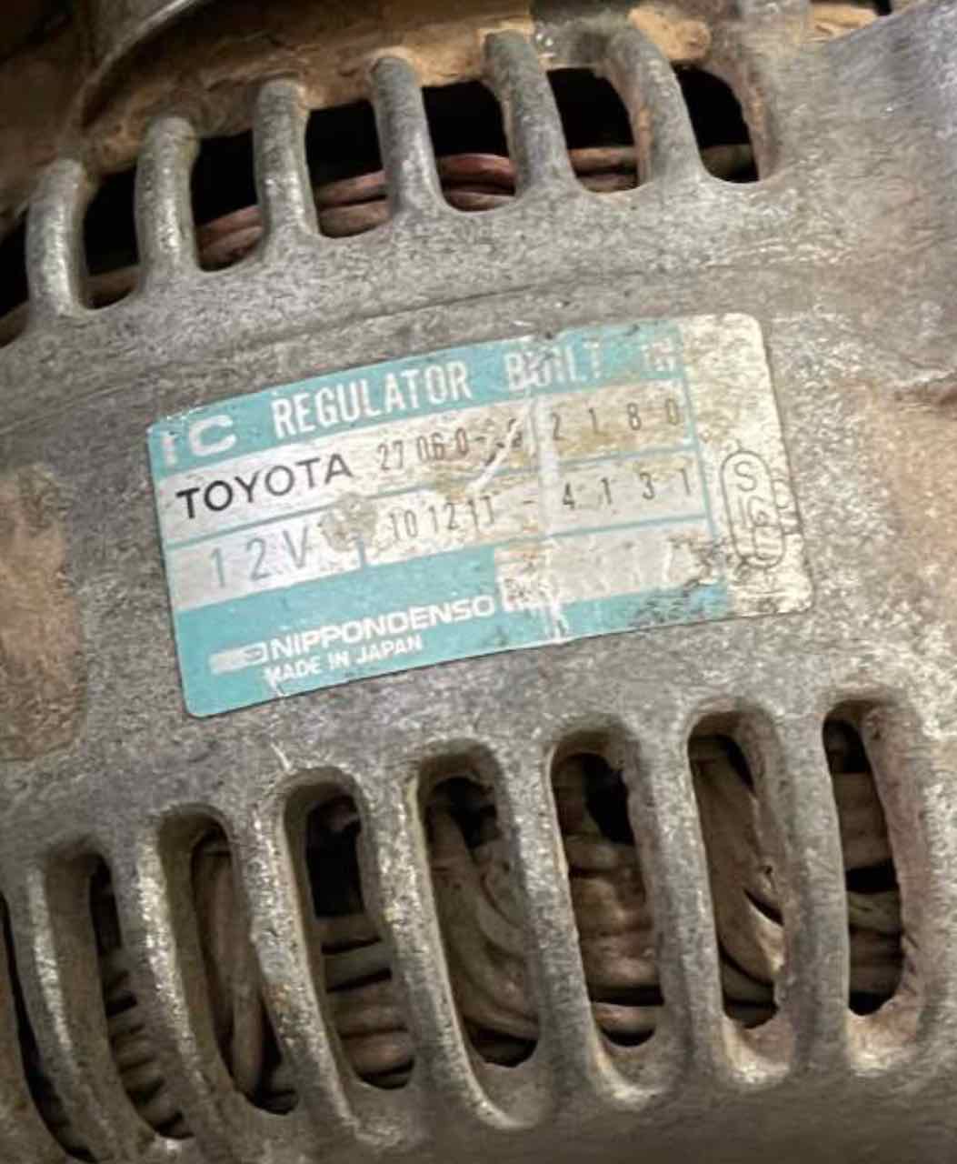

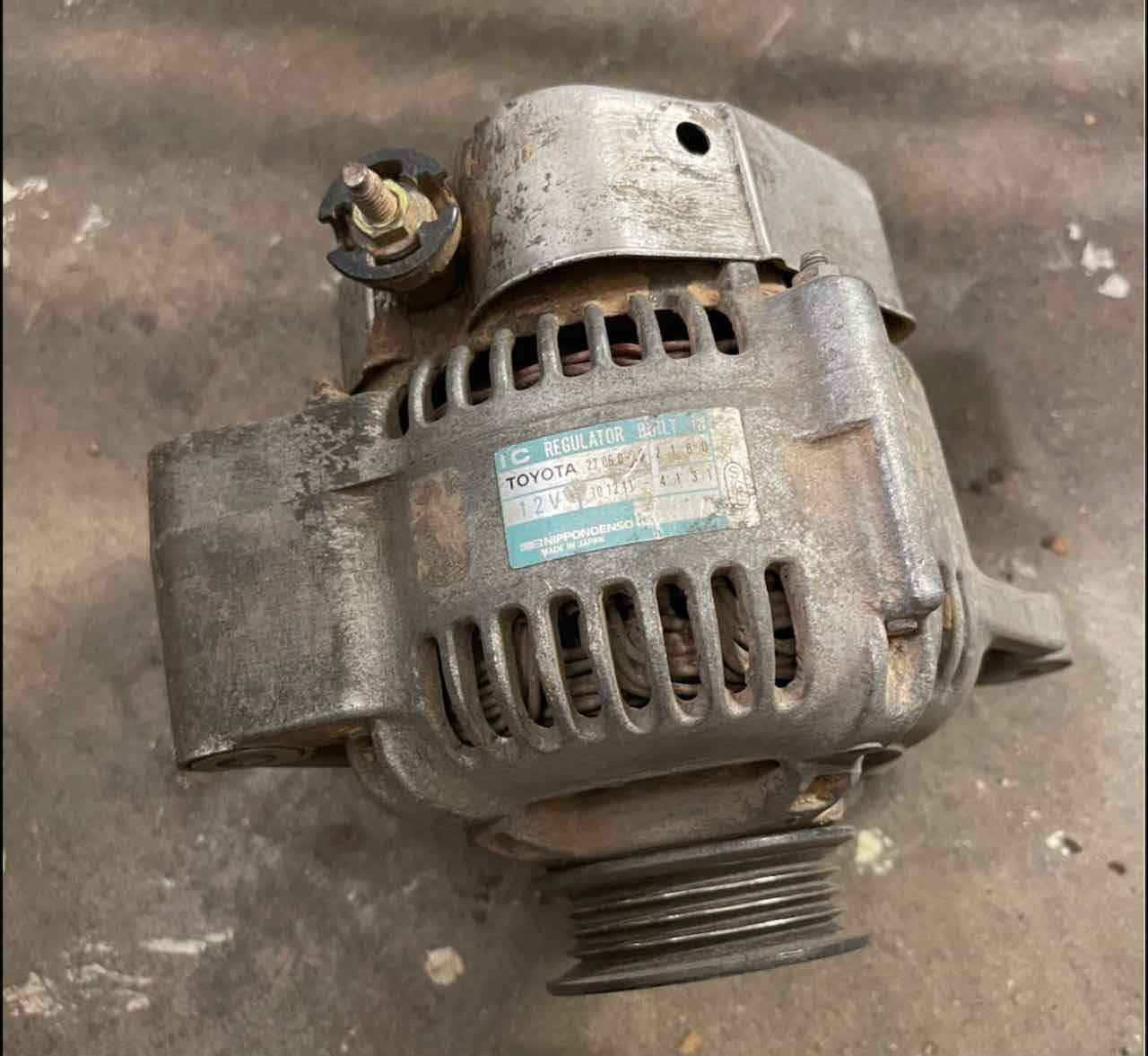

Came across someone selling this alternator. Wants $35. Thought it might be worth buying to rebuild it. I have zero experience with alternators but the windings look a bit corroded to me.
Any thoughts about it being worth the effort?
