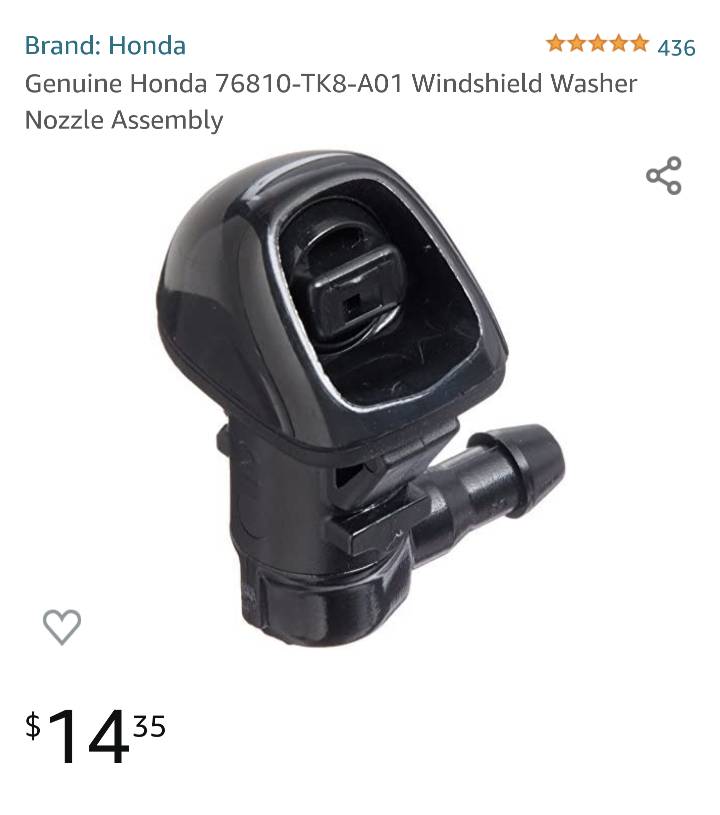

Honda part number 76810-TK8-A01
Not worth the hassle or shipping expense to order from a Honda dealer to save a few bucks, most are $10-11 each plus tax and shipping
