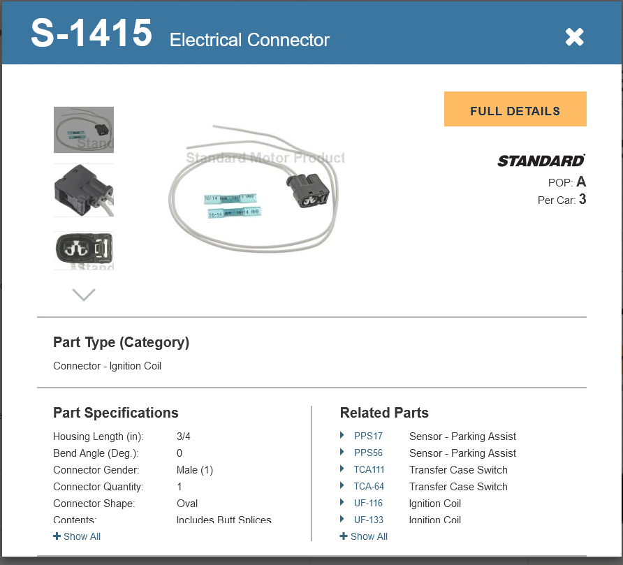

Startup/running is rough for the first few minutes when there is significant humidity/fog; this indicates moisture is impacting the connections/ignition.
I sprayed the ignition coil connectors (wiring harness side) and the coil connectors (ignition coil side) with electrical contact cleaner and it fixes the problem for a month, then the problem returns.
The problem is that the ignition coil connector (wiring harness side) has cracks in the soft rubberized connector part (that keeps out moisture) - this needs to be replaced and I cannot locate the part number in my reference material.
Anyone have the part number for the replacement connectors or have an alternative option for replacement?
Thanks again everyone!
1997 4Runner SR5 4WD Automatic 3.4L
These should work.
Amazon.com: NewYall Pack of 3 Ignition Coil Connector Plug Harness : Automotive

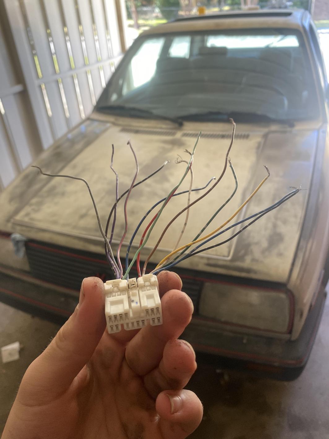

Good morning everyone I am trying to take my old single din OEM stereo form my 1997 and put it in my 1985 VW golf GTI as a temp fix. The one issue I am having is all of the wiring diagrams I have found are either for double din stereos or for the two plugs coming off of the amp that comes with the original stereo. As I am not going to be using the amp. I need a single plug, single din wiring diagram for it. picture for the plug I need is attached. wiring it to the golf is no issue it literally only has 4 speakers, power and ground so those are the only wires I am going to need. I might also need to stop by home depo and buy some sort of switch because the original stereo for the golf was wired straight to the battery with no ignition switch and you would have to turn it on and off independently every time.
it's well documented all over the internet, but looking at it the way you're holding it, the 4 pairs of wires on the left are speakers.
Big yellow on the right is BAT power, black is gnd. Red is switched power and blue is antenna power trigger (out)
