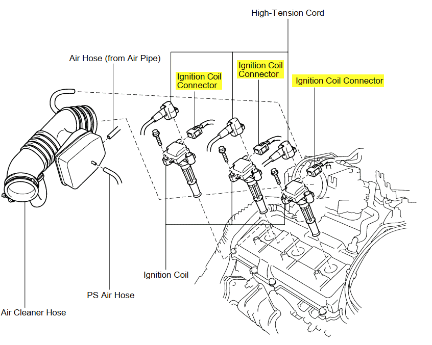

I hope someone could help me out with this problem.
Startup/running is rough for the first few minutes when there is significant humidity/fog,
This indicates moisture is impacting the connections/ignition.
I sprayed the ignition coil connectors (wiring harness side) and the coil connectors (ignition coil side) with electrical contact cleaner and it fixes the problem for a month, then the problem returns.
The problem is that the ignition coil connector (wiring harness side) has cracks in the soft rubberized connector part (that keeps out moisture) - this needs to be replaced and I cannot locate the part number in my reference material.
Anyone have the part number for the replacement connector or have an alternative option for replacement?

I'd put your full question again along with your model year and engine. It may also be helpful to post a picture as I am struggling to understand what exactly you are trying to find.

Startup/running is rough for the first few minutes when there is significant humidity/fog; this indicates moisture is impacting the connections/ignition.
Anyone have the part number for the replacement connectors or have an alternative option for replacement?

1997 4Runner SR5 4WD Automatic 3.4L

I don't have an EWD for a 97 and the connectors are different from my 2000. What about filling the connector with silicone where the weather seal is?
