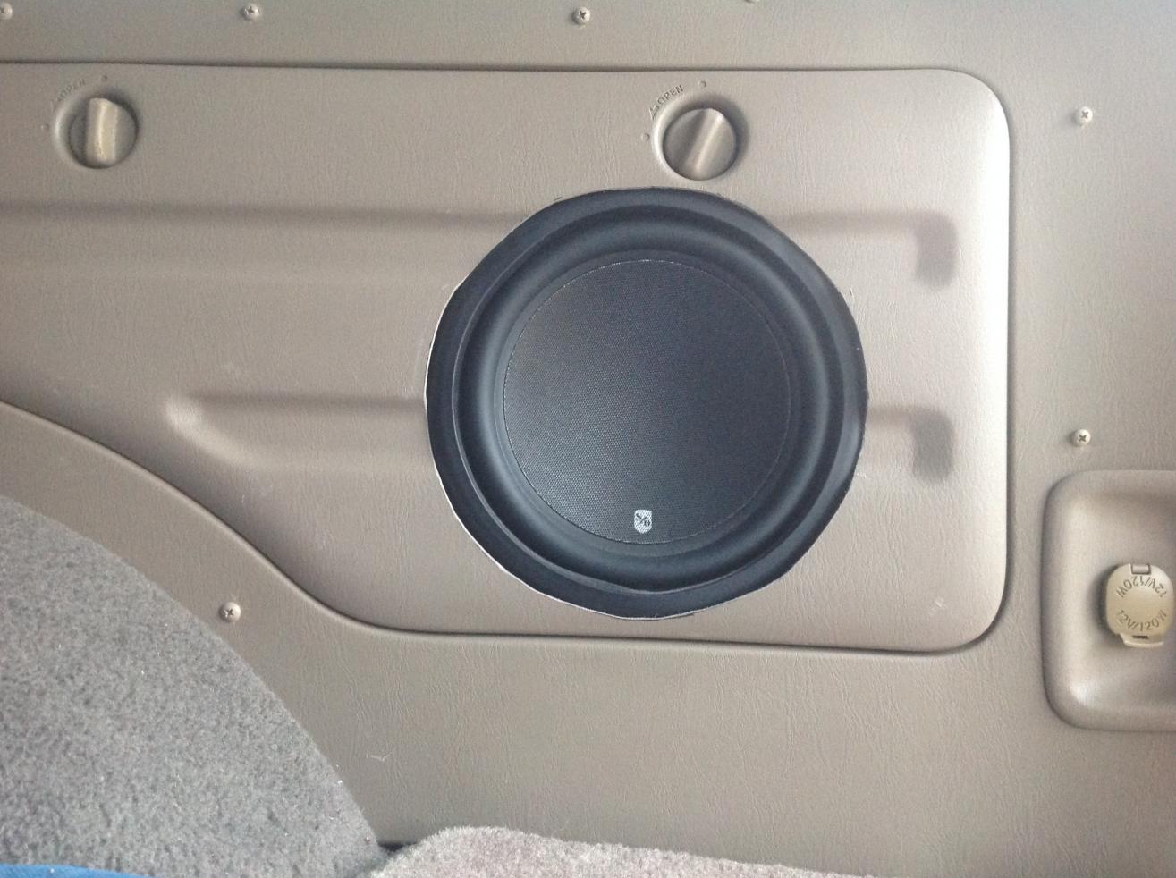

Also I love that subwoofer setup you have that utilizes the back storage area. If you don’t mind me asking, how did you wire it up and cut it to fit? I have a 10” sub in the back and hate the bulky box that it has; always have wanted something more low-profile.

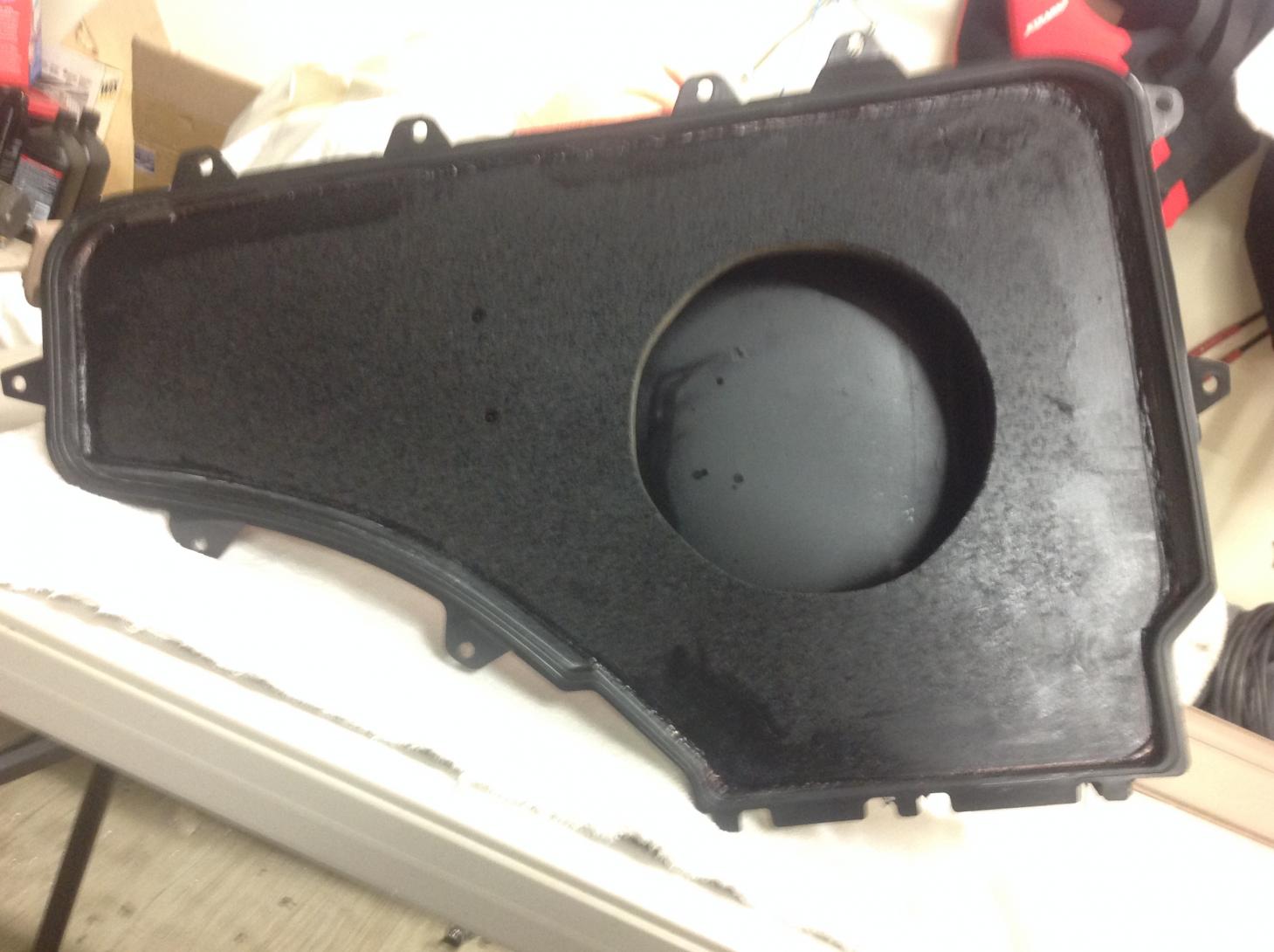

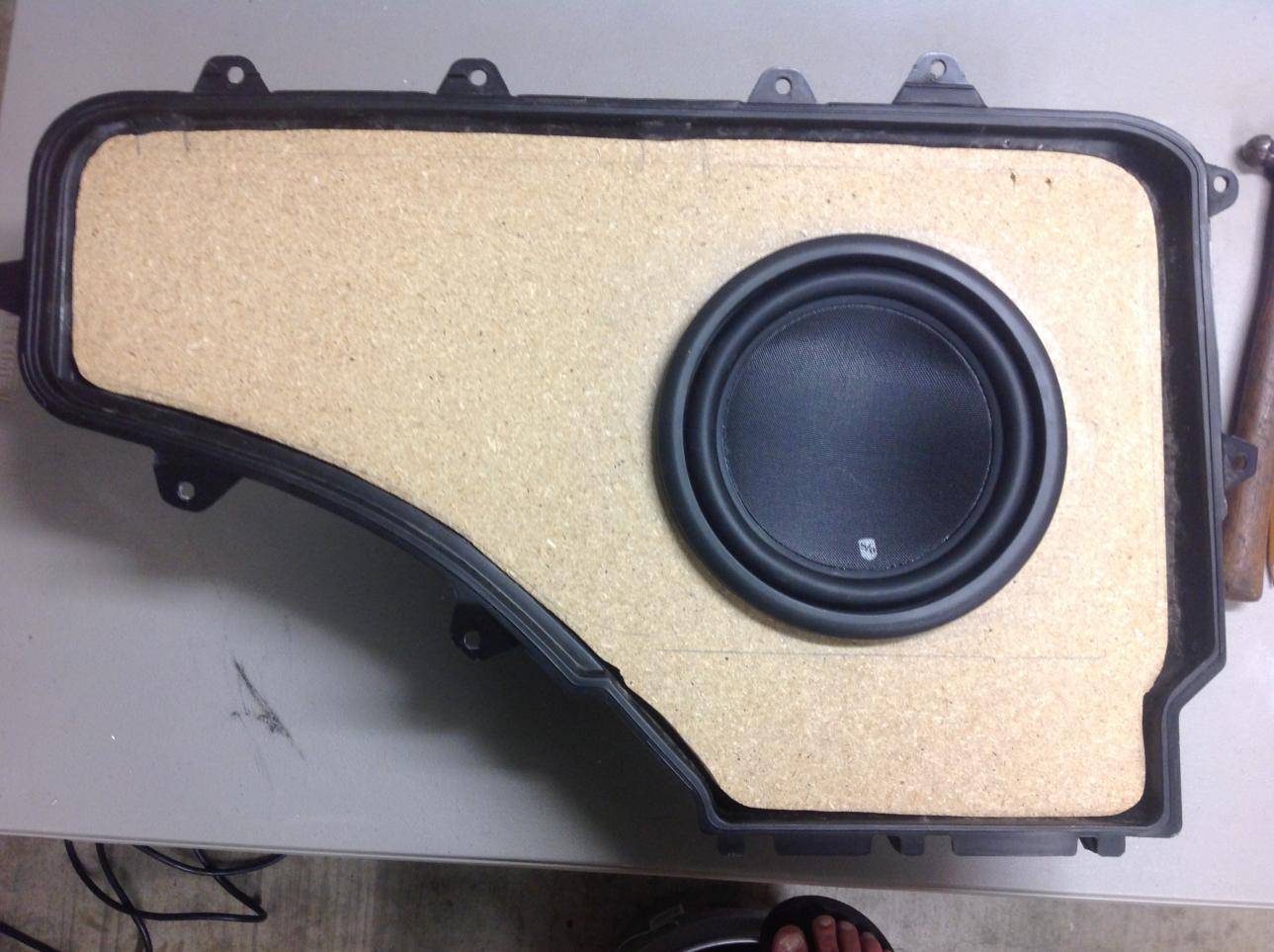

subwoofer setup how did you wire it up and cut it to fit?.
HDF glued screwed sealed 3/8" of foilbacked mastic on outside of tub
reattached Tub to inner panel rewelding plastic and Phillips screws.
Cover knobs are Velcroed in place that hide screws holding cover in place.
Amp under driver seat.
Math worked out perfect for 8" heaviest and max depth for box sub I could find.
Partial baffle left of hole sealed box.
Lowly 400w feed you can make it thump the rear view mirror a bit.
My fix for rollin with 10" box for years.
