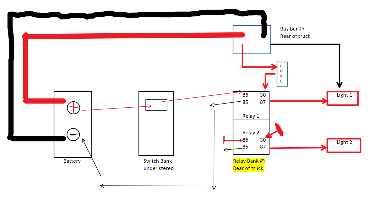

I'm assuming you are using relays at the rear main power/ground to control it? Otherwise you would still be flowing the full current through the switch and it would be pointless to run a main power and ground to the rear.
Right, like a relay box in the back with room for 4-6 relays or something like that, just so that if you are going to go through the trouble of routing cables, you only do it once, and then if you decide to add something else to the back of the truck, you just throw in another relay and wire up your accessory.
That makes sense to me. I don't see why it wouldn't work and that's a good way to do it if you have several things in the rear to power and control in my opinion. Good idea!
Here's sort of a mockup of what I was thinking but in the real scenario there would be something like a 6 slot relay bank in the bank (several things I have planned already, plus room for future expansion).
whnLJdhGo21BLoZ2ZVA_rEftvIxifPj8pkXRt-DeAaRItg_bHGRq2LsU37HSTPZZS-j9sDGEe2y4vllj6n_jk6c1GVQABytw1zMeooU0kQOgsQdHi0WjPLj5-jVjZTdcqmiVMdynp2xlV_df64G3xuN7M59bhw5C0D2rOldCvdaTPzXt7m1ZoSElyNZ-qdbAz_xlUyhb0MZD4sp7omq-f6EugZg4-0pt_ZrFCY_vOqB3UvMbAg_wmfP0667gOo_ItCDJCjVw3mSMsduVTvn8_jSVLAcr9R4oKe_jE6Vt1_HPrmkBnRwgKAqnSEWxKhYSHj1ZDoLnEKgri67fSeAJGAUYvzP1eaa2QXXo0cX7YRab-RAdzaE0uexS2jjnvYbHT68XMzPinakNMPrMb7jXT8rtU3BP4DVdk8kFEE33hx6a5N3xItIoXCwJ2qJ_3mcQ4Sex0qLE3smBpfxySHq1nV5f5gNt3l4qUgHl_GHD8gnTS6KkRkrNoIjhQUKw8kk82FxT4xakdHF_4B-jBIYYAJwsPkZ6JPvqkDwOzRmWOsOTBL_kltM-JQen6rr2JizdRsMM00TjELXQA-18RWFK7DYz-Nxybt3_Tt1SdPp7xF08Sk0uLeUs_AZFRAYZm-gG3y3GnAR7PeliBRZyYWAteZgnoc3c9aj3nDIghDuciZghbkYowMe0QwYUAK_j=w1194-h642-no
Photo isn't working for me
How about now, it should be attached to the post
That's better! That's about what I had pictured in my head. If it were me, I would use the main ground wire for the relay grounds rather than run the relay ground all the way back up front to the battery. I'd run an inline fuse by the battery on the main power cable to the rear similar to if you were powering an amplifier.
Yeah, that makes sense actually and should save some wiring. Are there any good tutorials that you know of for amp installs? I've never actually done one.

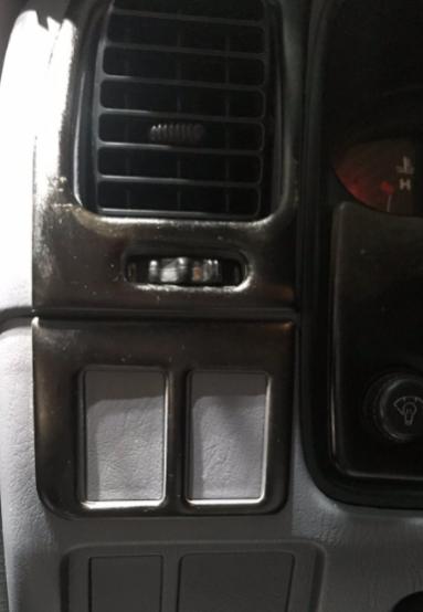

Anyone ever removed this faux wood stuff? I hate the look of it and actually replaced my climate control panel because I marred up the original so badly trying to remove it. So, any tips for how to remove it without ruining my dash?
Get yourself a good heat gun. That's clearly aftermarket there and I'm right there with you on the faux wood. It's gonna be some glue residue and once heated up everything should come off cleanly but you'll have to scrape and pull off remaining stuff. Take some soap and water to it at the end and that should really clean things up. Good luck and hope this helps.
