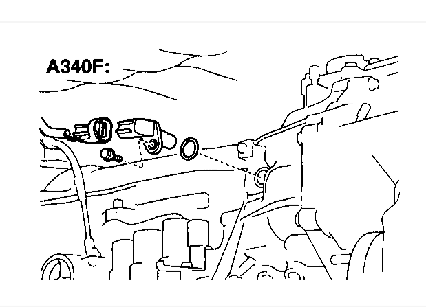

Not real sure I have just read any detailed amswers from you. I have been trying last few weeks to trouble shoot V0500 (VSS A) wow diagram runs through cruise and ECU. vechicle Speed sensor had been replace I replaced it again some references call the rev sensor. I also changed all 4 ABS speed sensors. Several other issues not popping codes yet. I can’t clear 0500 to keep going. Symptoms rev limit of 3k no power up hill down hill can run 75 but on level 60 is it. Check engine comes on sometimes while I am trying to complete drive cycles. Pretty sure rear diff has seal leaking onto abs ring only thing I see on this truck out of adjustment. Ty for info on etcs I’m headed there now. :juggle:
I should have written I am not sure where I saw the original quote. I HAVE read MANY answers you have give and they always have substance. My 2001 T4R has a different auto trans than 99 Tacoma and the Vechicle speed sensor each auto parts store wants to sell me fits the Tacoma the apparent same sensor on mine is referred to any many manuals as VSS but the sensor that fits is sold as output shaft sensor it fits secure with bigger bolt. Thanks for any different direction.trying to find auto trans diagram
The vss code p0500 vehicle speed sensor malfunction. It's located on the Transmission. The part number on Toyota parts site for a 2001 shows up as 8941150010. The etcs is for the throttle body control and is in use on the 2001-2 t4r's when in cruise control only. The accelerator cable controls the speed otherwise. The axle leak on the rear abs should set an abs code for that specific sensor but I am not sure if it would also set code p0500. On 2001 and 2002 a zero point calibration needs to be performed also. Hope this helps.
Note: In most cases a p0500 code would trigger vsc light and in some instances the speedo doesn't work. Good luck.
