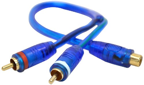

Turns out that it had a hollow core and was filled with some sort of paper or light foam :eek: ...light foam??? I tried to get it out with an extracting tool that I made; it's just a small gauge, coarse threaded screw with a super sharp tip, but N/G, it spun and moved further in the hole. I tested the amp's Right (RED) input but it's dead. So before I go any further with the upgrade, I have to restore the system to it's full working order! Tomorrow, I'll remove the amp from the truck, take it apart and see what went wrong in there; I just hope that nothing on the input board (Op-amp) was damaged! Here's the RCA cable that has caused all this trouble:
It's made by DB-Link. Here's the link to where I bought them: Amazon.com : DB Link Double Shielded Competition Series CLY2MZ 2 Male To 1 Female RCA Y Adapter : Vehicle Amplifier Stereo Patch Cables : Car Electronics I have nothing negative to say about Amazon, or the seller; I get most of my stuff from them because of the their low prices and the convenience! What gets me is that these shielded cables only cost $3 bucks... not worth sending back to the manufacturer, but I will leave some very unfavorable reviews wherever I can about this product; there are a few sites where I leave reviews about products that I come across... but most of my reviews are very favorable... don't have time to spend complaining but I'll make ^X to review this piece of garbage just to prevent others from having to go through this... I really shouldn't have to make an amp repair for something as stupid as this!!
CAUTION: Please Do Not use or buy this product!!
I'll be installing the door speakers as soon as I get a handle on what's needed for this repair. ...until then, you know what...
