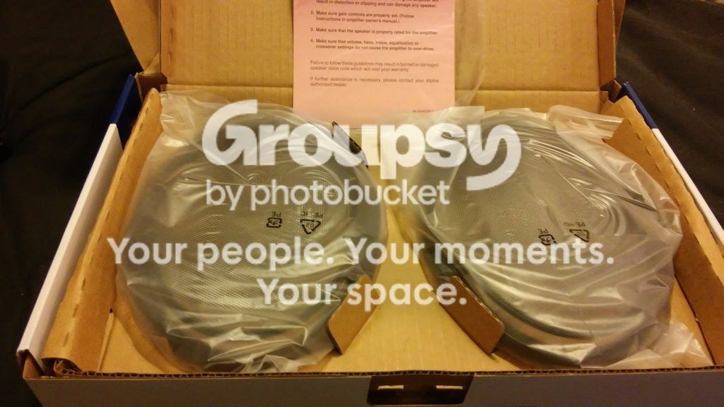

THE 'ALPINE' SPR-69 $100 bucks

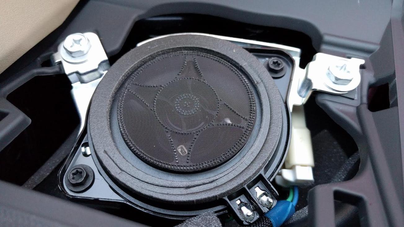

HERE'S THE OLD SPEAKER that's coming out...
It looks like a speaker from an old QUASAR console T.V. that we had in the living room when we were growing up!

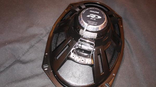

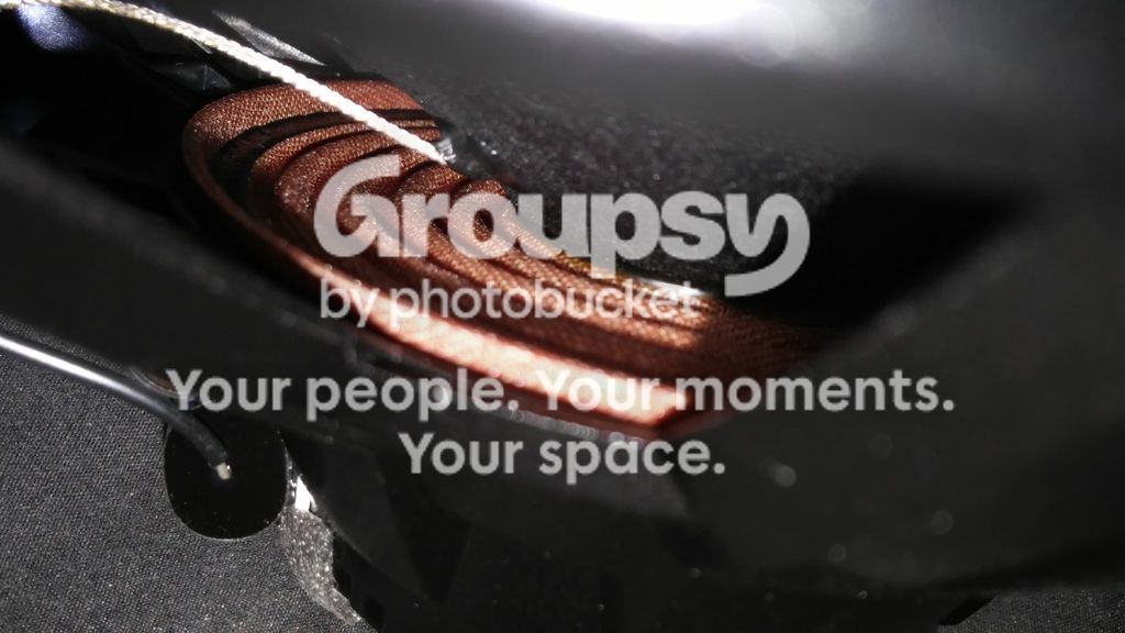

AND HERE'S OUR NEW 'SPR-69'
I'M DIGGIN' THE BUILD QUALITY OF THIS DEVICE; IT'S DESIGNED LIKE A "PRO-AUDIO" DRIVER!

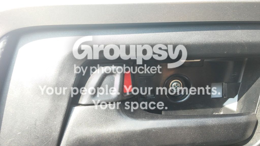

FIRST TO REMOVE THE DOOR TRIM PANELS

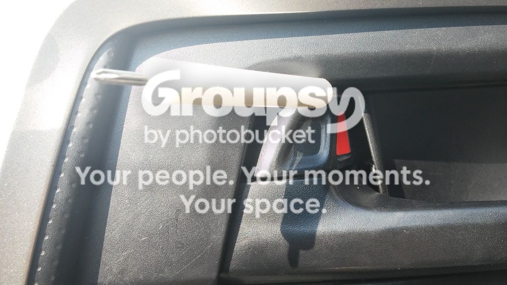

There are three screws that hold the trim panel on. To access the screws, you must remove these screw covers; "see the small screwdriver tip as I remove the covers":
THERE'S ONE UNDER HERE TOO!
OKAY NOW THAT THE SCREWS ARE ALL OUT IT'LL JUST SNAP APART/ PS: Do yourself a 'HUGE' favor ('BEFORE you start') and P/U a pack of Door trim panel plastic push clips like these:

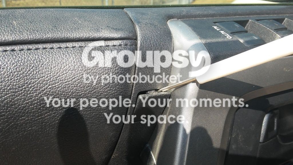

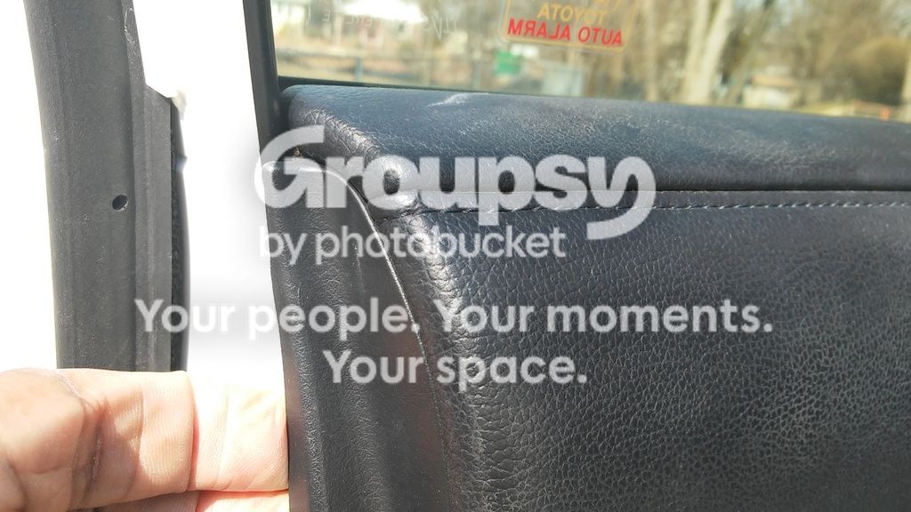

DOOR TRIM REMOVAL Pull this plastic triangle off first, just pull straight back:
USING YOUR HAND, GRAB IT HERE AND PULL
NOW GRAB IT UP HERE AND PULL STRAIGHT OUT TOWARDS YOU

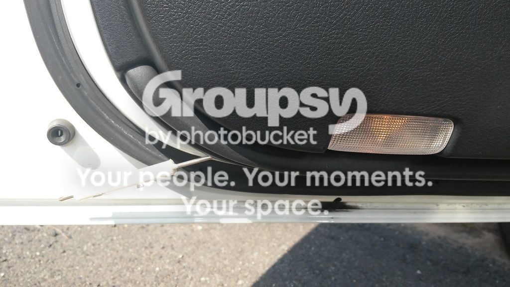

THIS IS ULTRA IMPORTANT!!!
I've seen guys lifting this widow sill flange up and off; problem is if you do it that way it's almost impossible to get it back on... could take 30 minutes to an hour "If you're lucky!" Don't do that beloved. You pull the trim panel off of the track flange just like you did the others; straight back towards yourself... look at the clips once the trim panel has been removed; they're made to stay there and release the plastic clips as you pull. You'll see what I mean when you put the trim panel back on in about 60 seconds hahaha!
"See the clip retainers accented by the green circles, That flange stays there where it is! DO NOT LIFT OR REMOVE!"
I MARKED THE PLASTIC CLIPS W/ RED ARROWS FOR YOU TO SEE WHAT WAS HOLDING THE PANEL ON ...and you thought it was by magic!

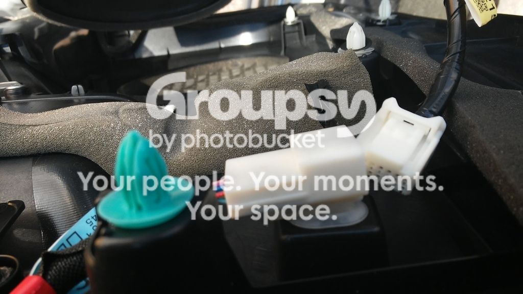

NOW THAT THE PANEL IS OFF UNPLUG THE COURTESY LIGHT (BOTTOM), THE 'WINDOW BUTTON/LOCK CONNECTORS' (TOP), AND THE SPEAKER.
THE WINDOW SWITCH PANEL
THE SPEAKER CONNECTOR just push the retainer latch and pull the male harness straight out!
HERE'S THE OLD SPEAKER to be removed
NOW THE NEW ONE
