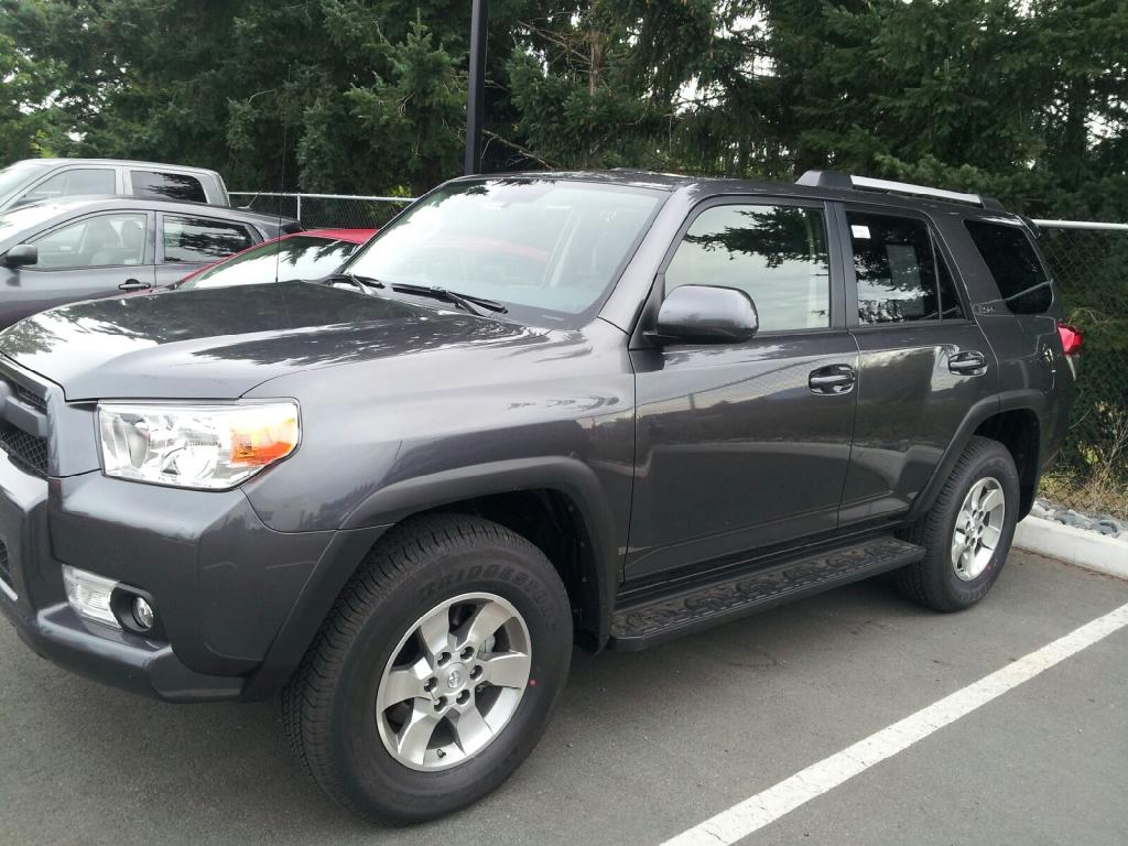

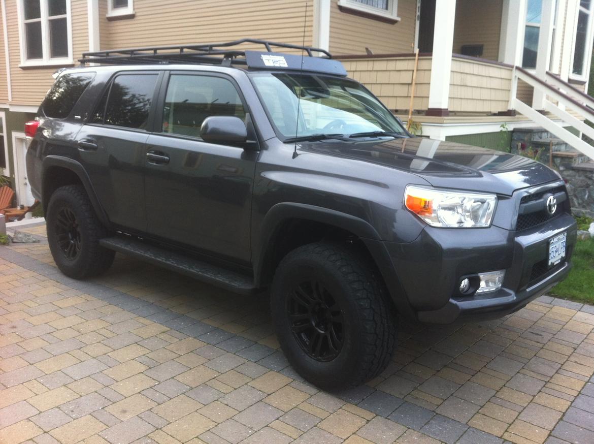

first id like to thank everyone who helped me out with information on their rigs. i ended up going with billies at 1.75" in the front with new LR UCAs and rear SAW coils. in reality it was pretty painless getting the install done....just had minor rubbing issues on the body mount/plastic front mud flap....so upon removal of the flap and a small adjustment in caster....and then a front liner mod....all is well. here are a few pics and really i dont think that the rake is all that much considering....but i dont believe i had 2 inchs of rake to begin with....
a little before and after comparison....
