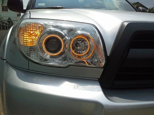

Hi Ilyas, i tried out some DIY. not as professional as yours though. thanks for your motivation. just felt i should show them to you. i will try and upload some pics. i used the amber colour option.

WOW GR8 JOB..@ SWAYEROLLA!!!..U FINALLY WENT THROUGH WITH THE PROJECT......do post more pics.......ur truck must be an eye turner....few modded runners in your neck of the woods

Hi! Well done, bro! But I think you should paint your headlights into black from inside (like I did). It will look better, be sure.
Did you wired the angels to DRLs? Are they work as DRLs and turn/hazard signals?
PS And of course, the eyelids are necessary :)
