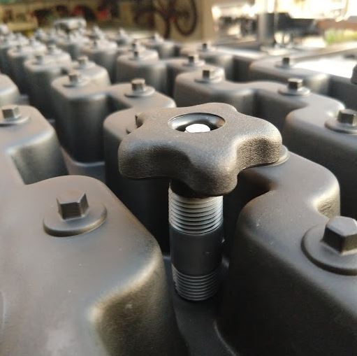

Looks good. What did you use to secure the boards down?
5" long 3/8 bolts, 4 of them. Others use two but when I did mine the boards were a little warped so I used 4. Held the bolts to the cross bar with a washer, a lock washer, and a nut. I think I used a 7/16 (or whatever the next size up was) flat washer since it is a little wider than a 3/8.
Now to hold the XBulls down, you can use a 1" od (outer diameter), 1/2 id (inner diameter), and 2" long steel bushing to go on top of the XBulls after you slide it on the 4 bolts. But they were expensive. Steel Bushing on EBay. Notice at $7 not too bad but they want $8 for shipping. I also found them at an Ace Hardware store (no shipping because it's in person) but they were $12 a piece. Since they are steel they will rust.
So I chose to go cheaper and go with a 1/2" PVC 2" connector pipe. It's threaded on each side but it's already pre-cut so much easier than buying a pipe and cutting it yourself. 70 cents a piece at Ace Hardware. Here is what it looks like although this isn't exact and is more expensive.
Then I screwed them down with 4 of these.
Pic. And thanks to Brick Sprickly for the help.

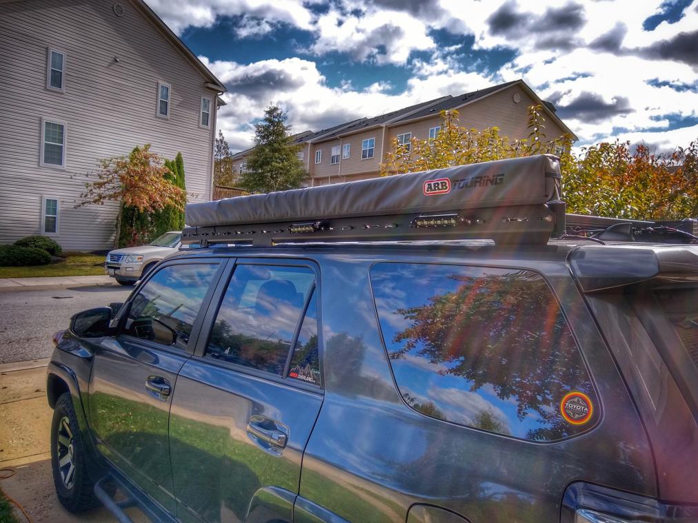

In case anyone is wondering, the ARB 2000 (2m) awning fits perfectly on the full length rack, and the 90 degree brackets space it out perfectly to the edge of the rack

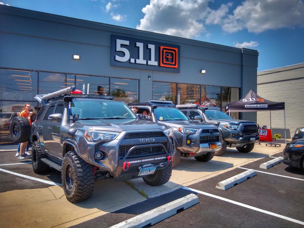

An ARB 2500 awning can fit on a 7/8... Not the greatest photo, but the closest truck has a LFD 7/8 rack and the (much) larger ARB 2500
