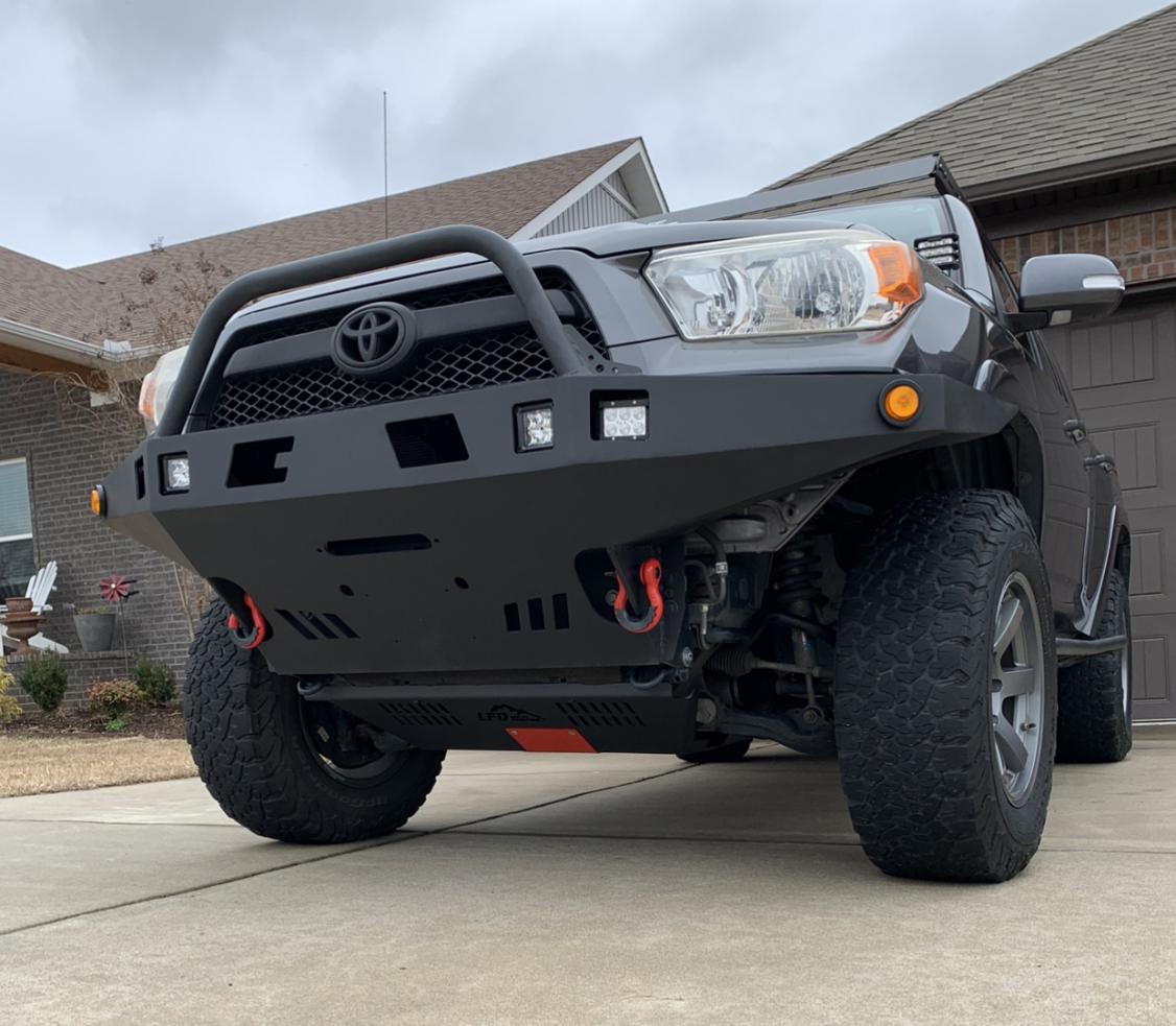

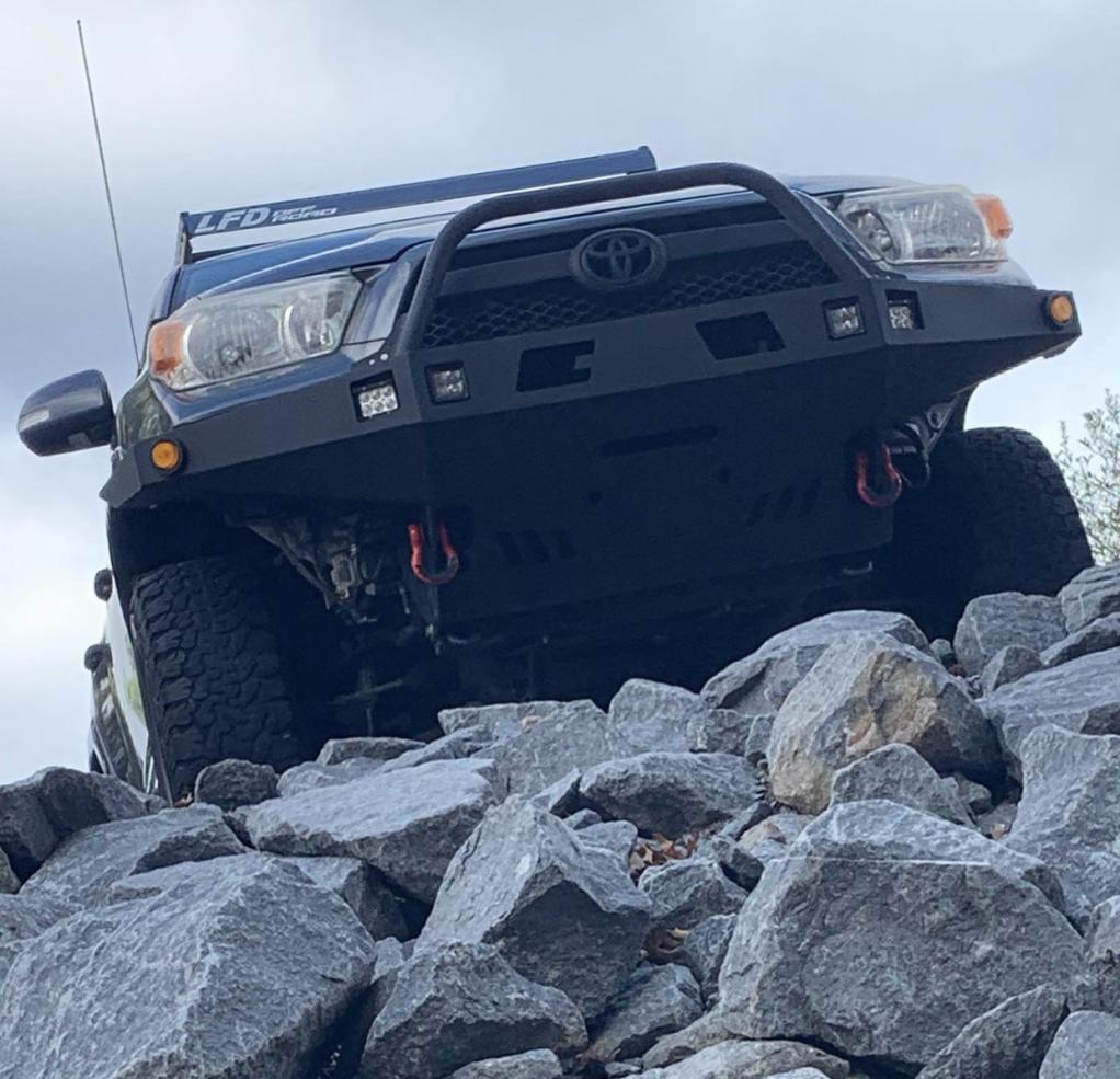

SR5 with LFD Hybrid Bumper
Installed the hybrid bumper - love it.
Little scarier with the SR5 since the "template" is the bumper valance that we don't have on a SR5.
I ended up cutting a little too much.
The bumper cover curves out over the bottom of the grill and I cut so much that the grill actually pokes out a bit.
I used some edge trim you can't tell unless you get close and really look.
If you have an SR5 - think about how that grill extends behind the bumper cover before you cut... I'm thinking about 1.5" down from the grill is about right.

What would you say is the added weight with the bumper and winch?
LFD Hybrid Bumper
Engo SR10 - Synthetic 10000lb Winch weighs 60 pounds.
LFD Hybrid Bumper weighs 83.2 lbs.
Stock Bumper I removed weighed 24.4 pounds.
Center of mass of new gear is a bit forward of stock bumper so 60 + 83.2 - 24.4 = 118.8 isn't exactly right, but close.
I still have stock suspension and I think the front went down about 1/2 inch... hard to tell with various measurements.
Front skid plate seems to show it most.
