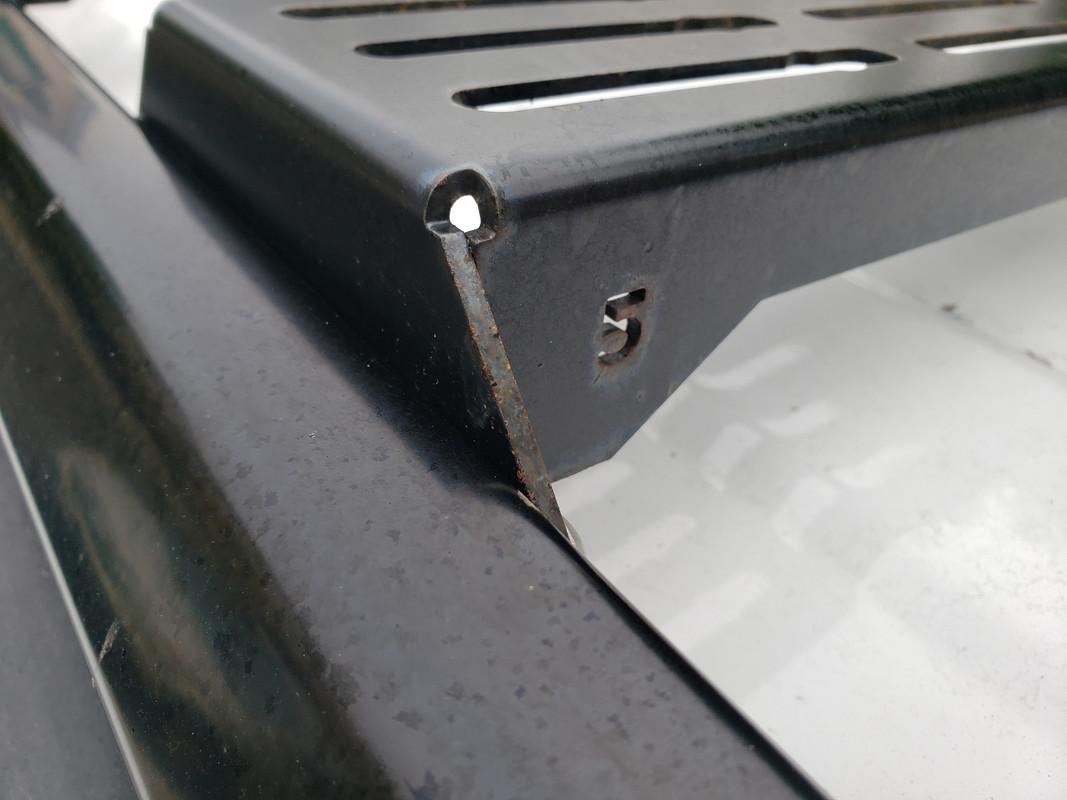

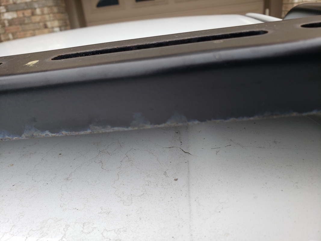

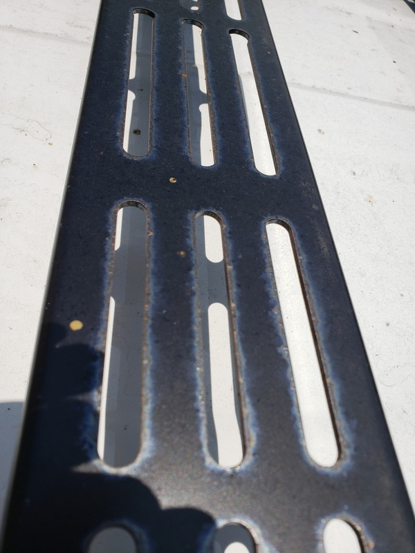

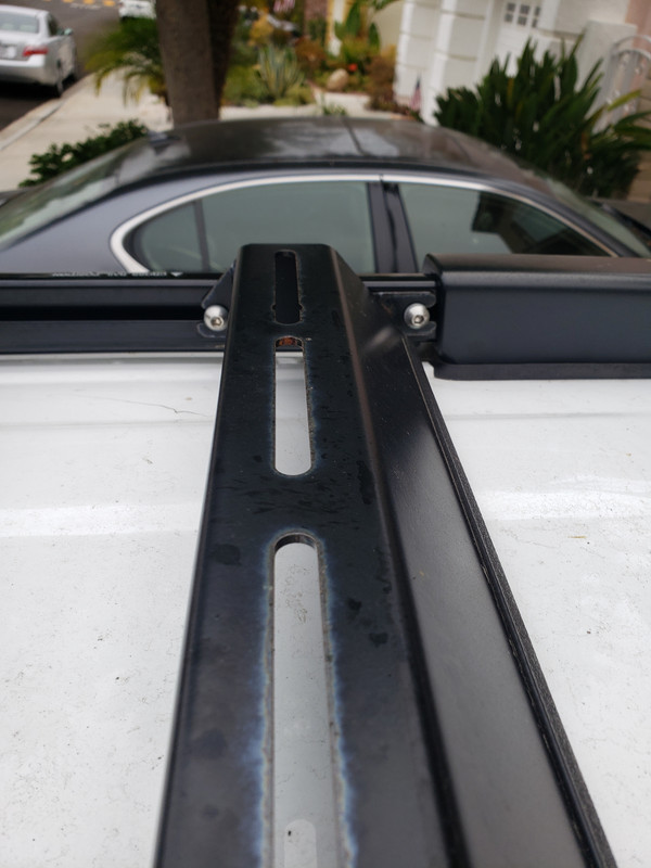

Keep an eye on your bars! I've had these installed for ~7 months and they are already looking like this, does this look normal to folks?
And this was in San Diego during a severely below average for precipitation year. You can see some areas are already rusting, others are close to following suit... and this was even without me installing anything on them.
I have 4 of the steel wide bars that I have on for at least 4 months now and haven’t noticed this. I will keep a look out. I’m in SoCal too. That’s not acceptable. It has only rained here a couple of times in the last four to five months, unfortunately.
Thanks, yeah I agree this is unacceptable... currently discussing how to remedy the situation with them. Must have been a bad batch of powdercoats because literally ever machined edge is degrading, after next winter I bet these bars will be totally rusted.

That's not normal. Definitely sounds like the powder coating company messed that up. I'm confident that the guys at LFD will do what they can to work with you to remedy this.
I had a couple of steel bars that are having issues with powder coat, but I am extremely hard on them and almost all of my LFD gear is at least 3 years old now. I plan to sand them down and repaint them once things cool off here. We've also had a ton of rain (like double our yearly average already). So, I was not surprised.

Mine are doing the same thing.
We’re on the Oregon coast but my 4Runner spends most of it’s time in the garage.
I’ve had mine for almost 3 years in the Gulf Coast Houston area. They look almost as new as when they arrived. Definitely a QC issue. I would seek replacement from LFD. I’ll post pics later.

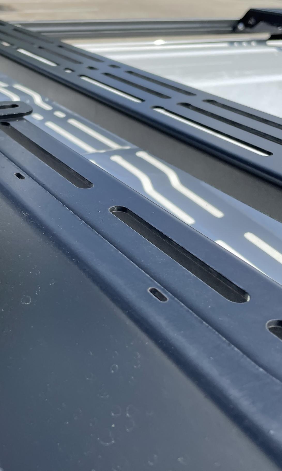

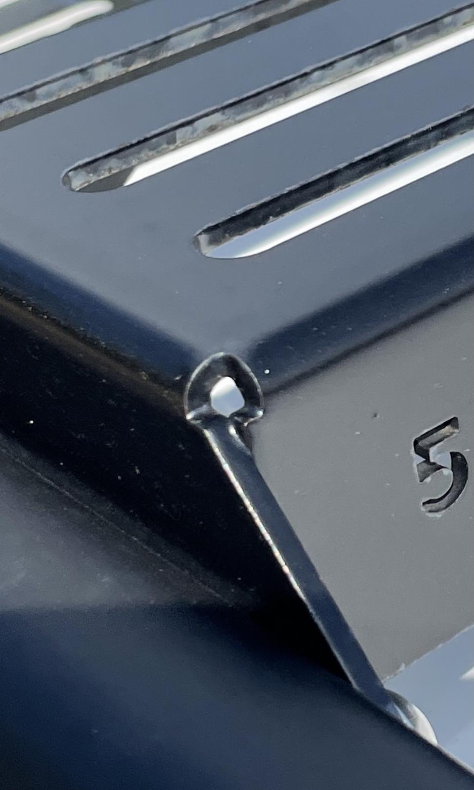

Back to the rust/erosion issue here are my 3yr old LFD crossbars. No rust of corrosion. I really like them. My only issue was with steel wind fairing. The QC wasn’t that great. The edges were pretty rough. To the credit of LFD they sent me an aluminum fairing which looks great! However at speeds above 80mph it howls like crazy so I went back to the steel one.
I’m very impressed with LFD and think their bars to fit the 4Runners OEM rails is a great product!
