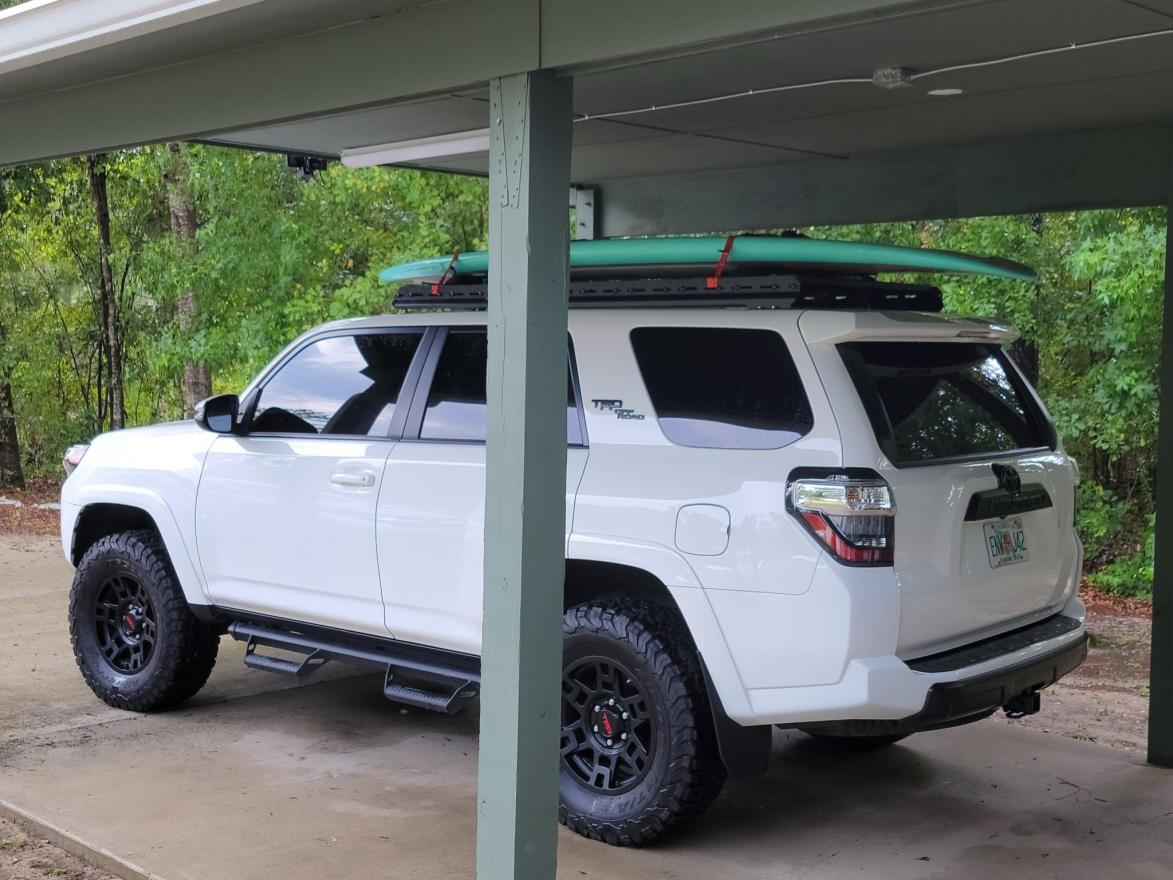

Installed full 7/8 lfd rack 2 years ago and live in hot Florida. I used loctite silicone. No issues yet.

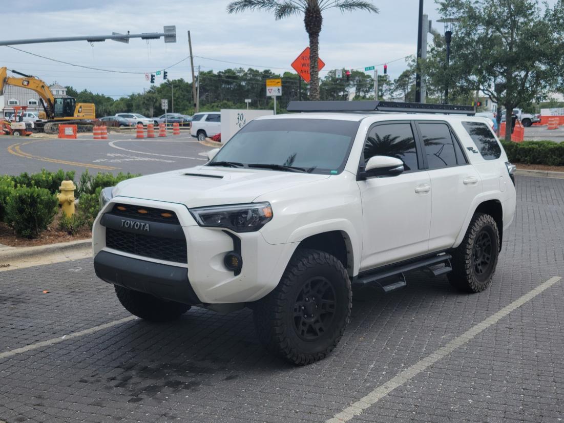

I will do, how is the noise with 4bars at 4” each, at 2” I hear pretty noisy. Have a fairing?
I drove it without a wind fairing and it was noticeably loud. After the wind fairing install, it cut the wind noise by about 90%. I consider the wind noise with the four wide bars equally spaced with the fairing to be very tolerable, but not as quiet as without any.
Thanks for this, I will go 2” given. Want to keep my options open for a RTT in the future.
