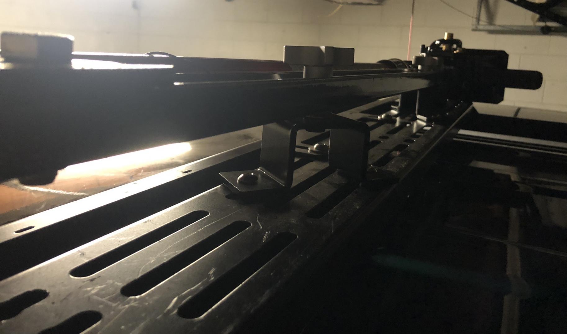

I know that the 48” seems to be the most popular, but, that did not fit my layout as well as the 42”. It was obvious that the mount was intended to be used longitudinally once I got it up there. Just seems that they would/could have an adapter to mount it transverse to that, especially with their wide bar. I’ve got some good ideas that will maintain rigidity and my placement. And yes, I can probably try rotating the mount 90 degrees to line up with the slot, Although, I’m not as comfortable with the fore-aft stresses on the bolts in that position with the moment exerted by the weight of the jack.

How are you attaching the Rollpax mounts to the LFD bars? I've never considered that option but it looks pretty slick.

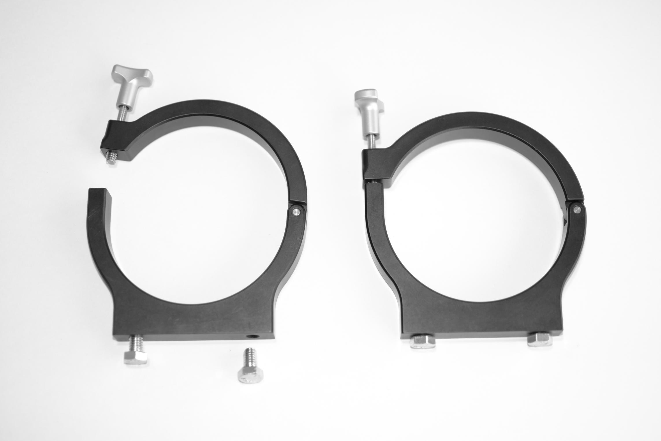

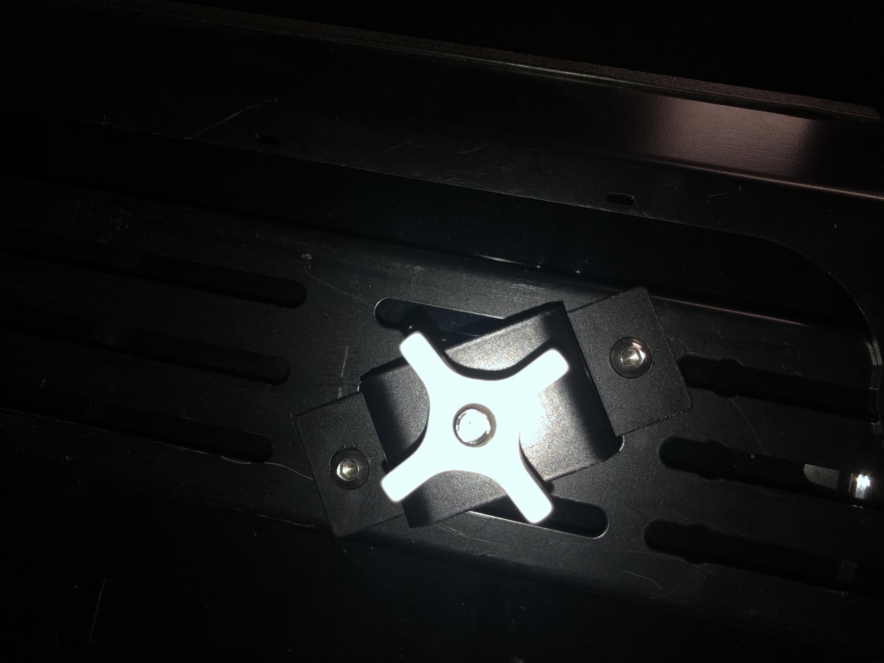

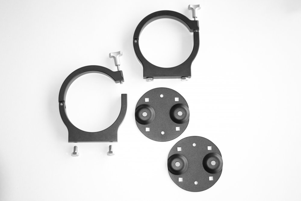

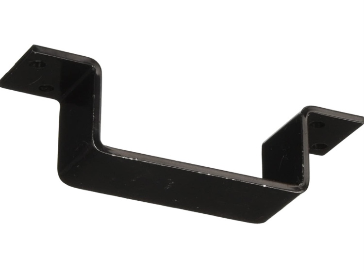

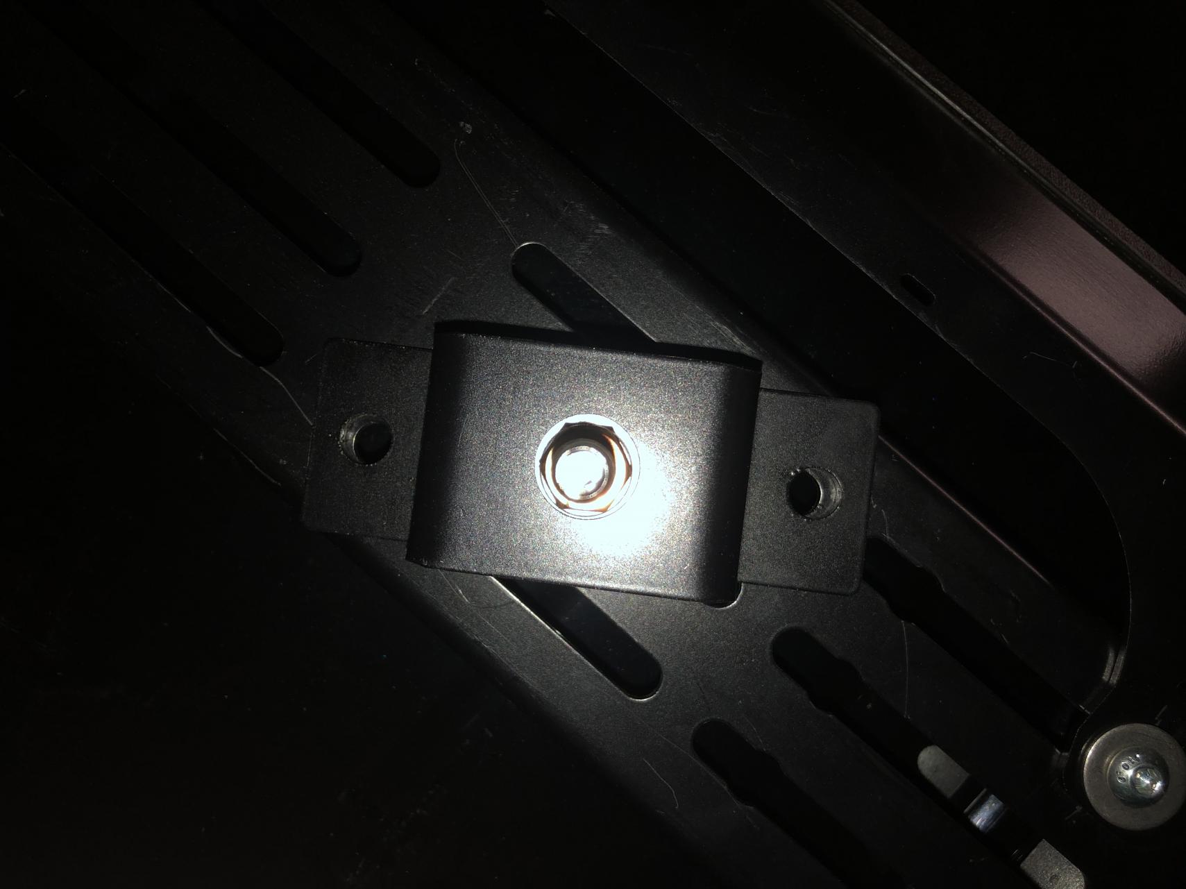

Something like this bracket shown attached fore-aft in two places with the bottom of the bracket drilled to accept the RollpaX mount. Attached/bolted to the first and second bars, but thicker and the Mounts shown that came with the RollpaX mounted to the bottom of the bracket with longer bolts/lock washers than what came with the flat mount option. There is a tubular mount option also. Edit: Note; the flat mounts that come with the RollpaX can be mounted directly to a standard size or wide bar with the adapter plate that comes with the RollpaX. I was just running out of room and needed the front bar for the weight of the jack. See adapter pic.

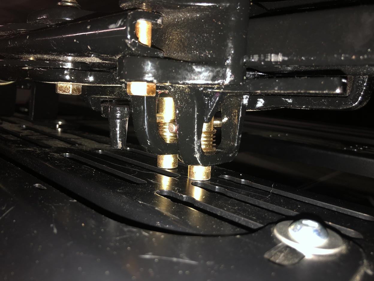

Rotated the mounts at approximately 45 degrees and moved them in to the 3rd row of slots that are a little longer than the first two sets of slots. This needs to be done for two reasons. One, I am going to run a fine thread hex head bolt in either 3/8-20 or 5/16-20 rather than the 1/4-28 button head bolt. 5/16 and 3/8 diameter fasteners do not fit in the first two rows of slots at an angle because the slot is not quite long enough. See pic. Second reason is in order to clear the Pitman assembly and lower handle clip they needed to move inward to the longer third row of slots. Another issue is that I have to have the handle in front for the clearance needed to remove the RollpaX and the Jack will not sit flush if loaded from the drivers side as the two large pins contact the crossbar first. If loaded from the passenger side, no problem. Mounts should be at least a 1/4” higher to add versatility to the mounting arrangement. Maybe I will do some simple lock wiring with the quick release knobs.

You may want to get another 2 pieces of metal to mount the hi-lift down lower. I almost did this before I moved my hi-lift to the LFD Rear Bumper.
