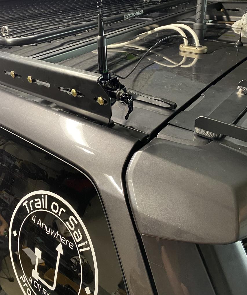

Nice! I gotta ask how you’re routing the wire to the inside.
I have a marine style cable gland in the roof where the shark fin antenna was. I am running solar, radio antenna leads, and light wiring through that one gland.
