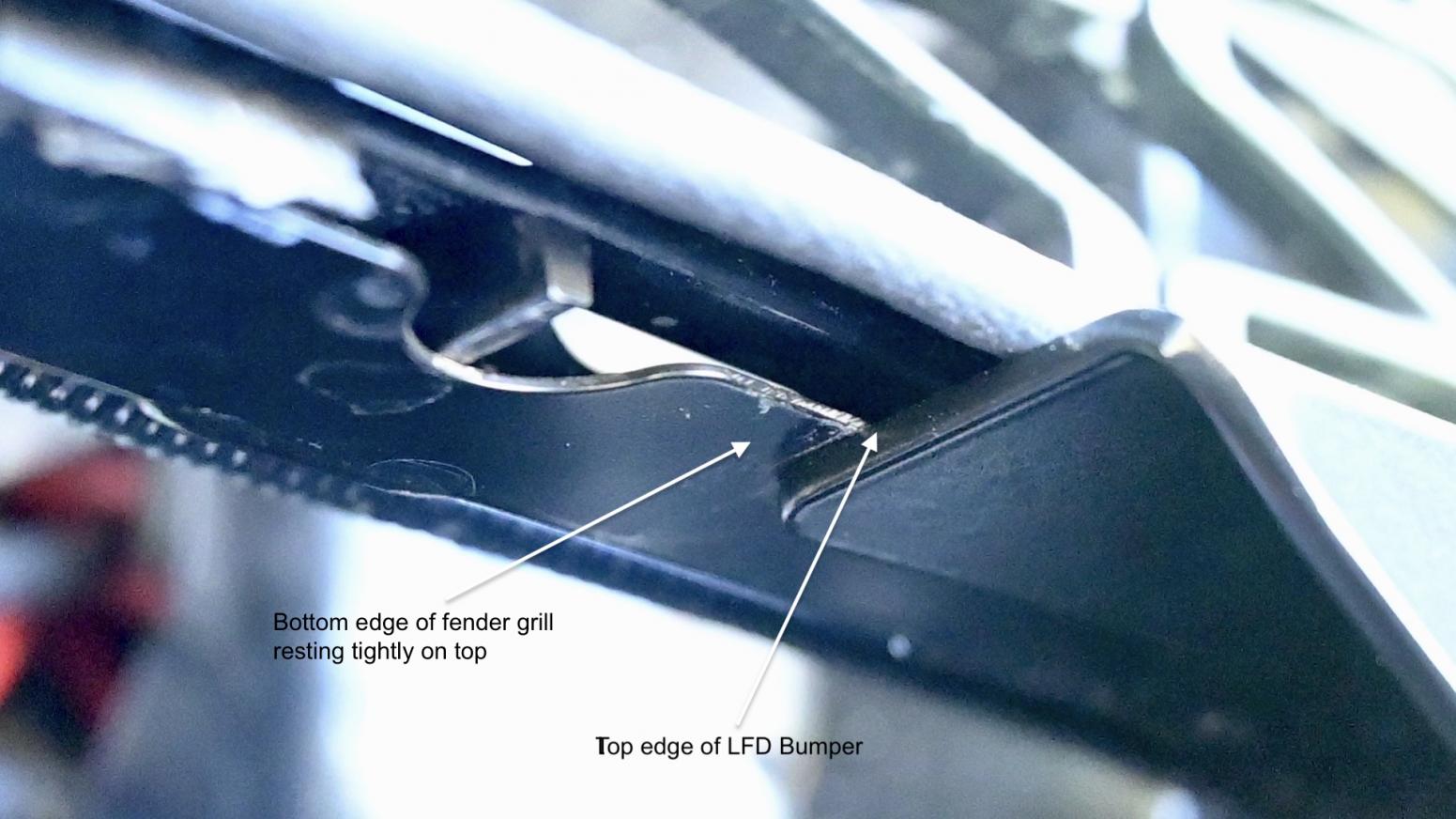

Hi,
Just installed the LFD bumper on a 2022 TRD Pro. Is the bottom of the fender grill suppose to sit tightly above the top of the bumper or behind it? See pic for reference.

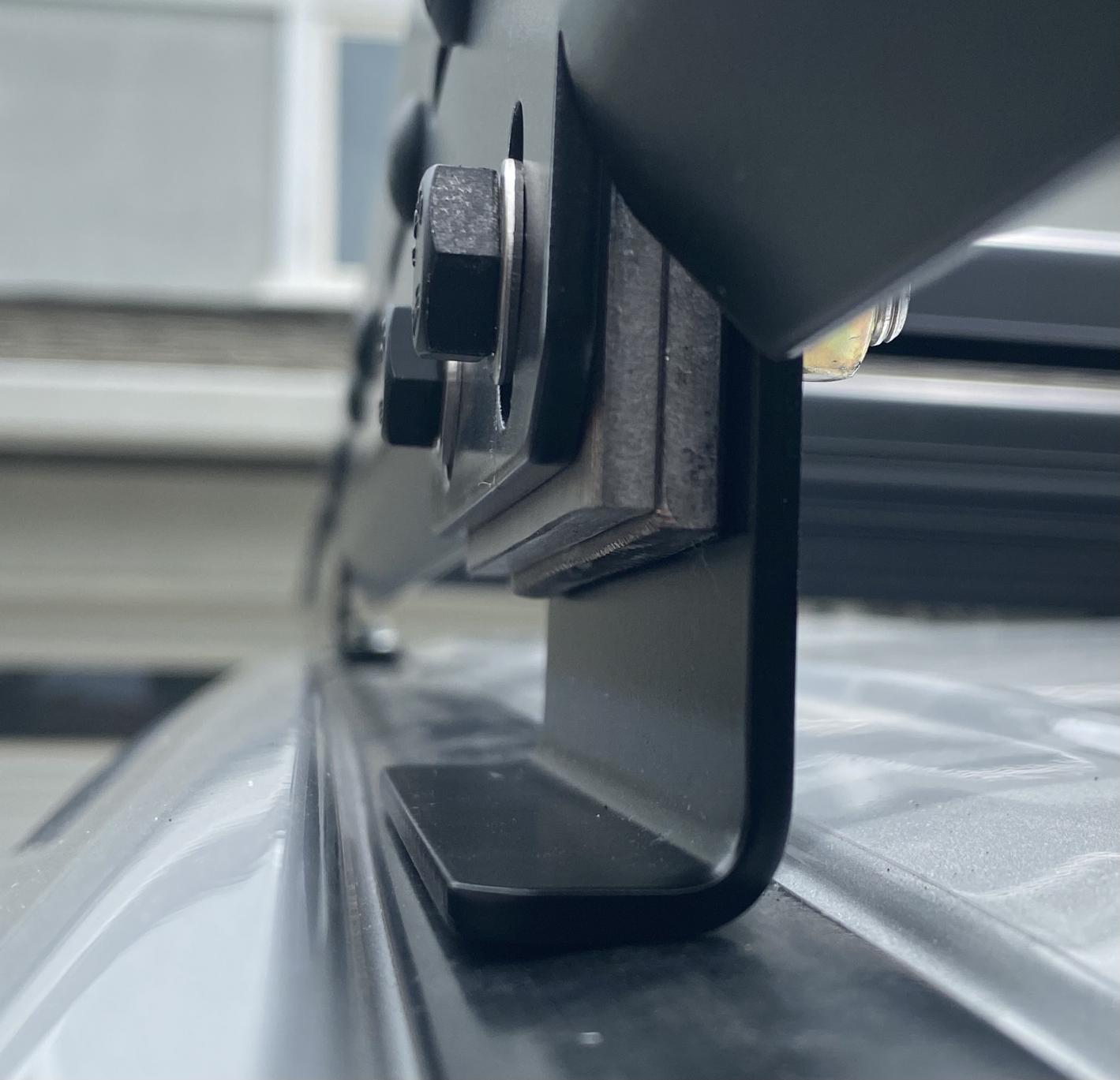

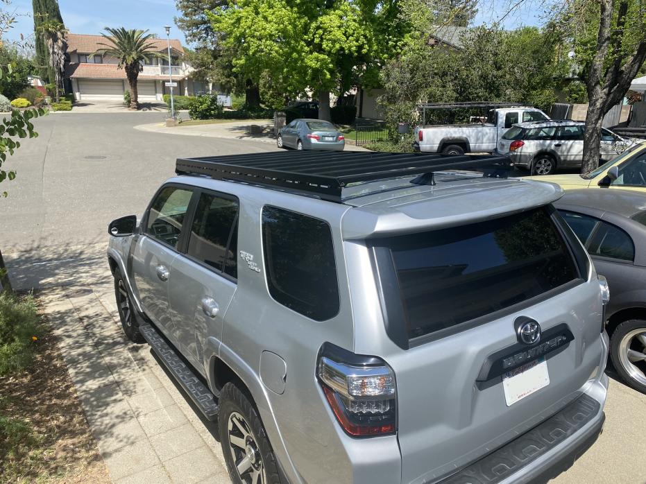

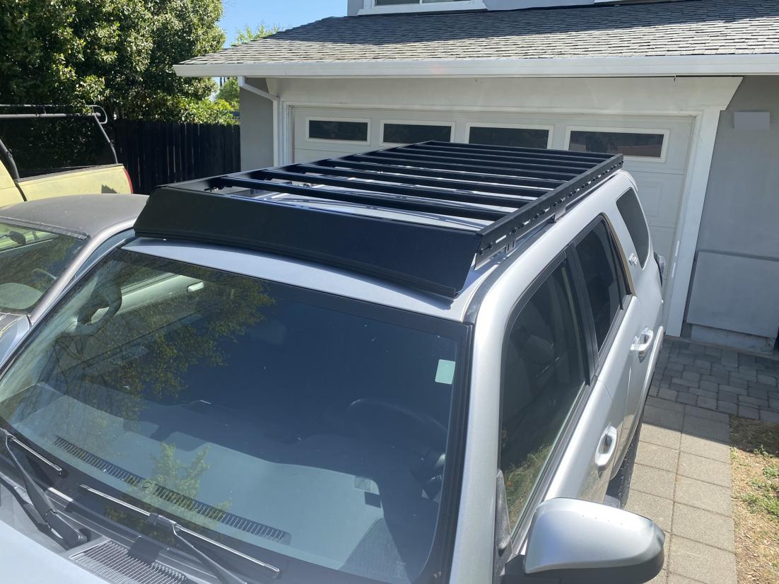

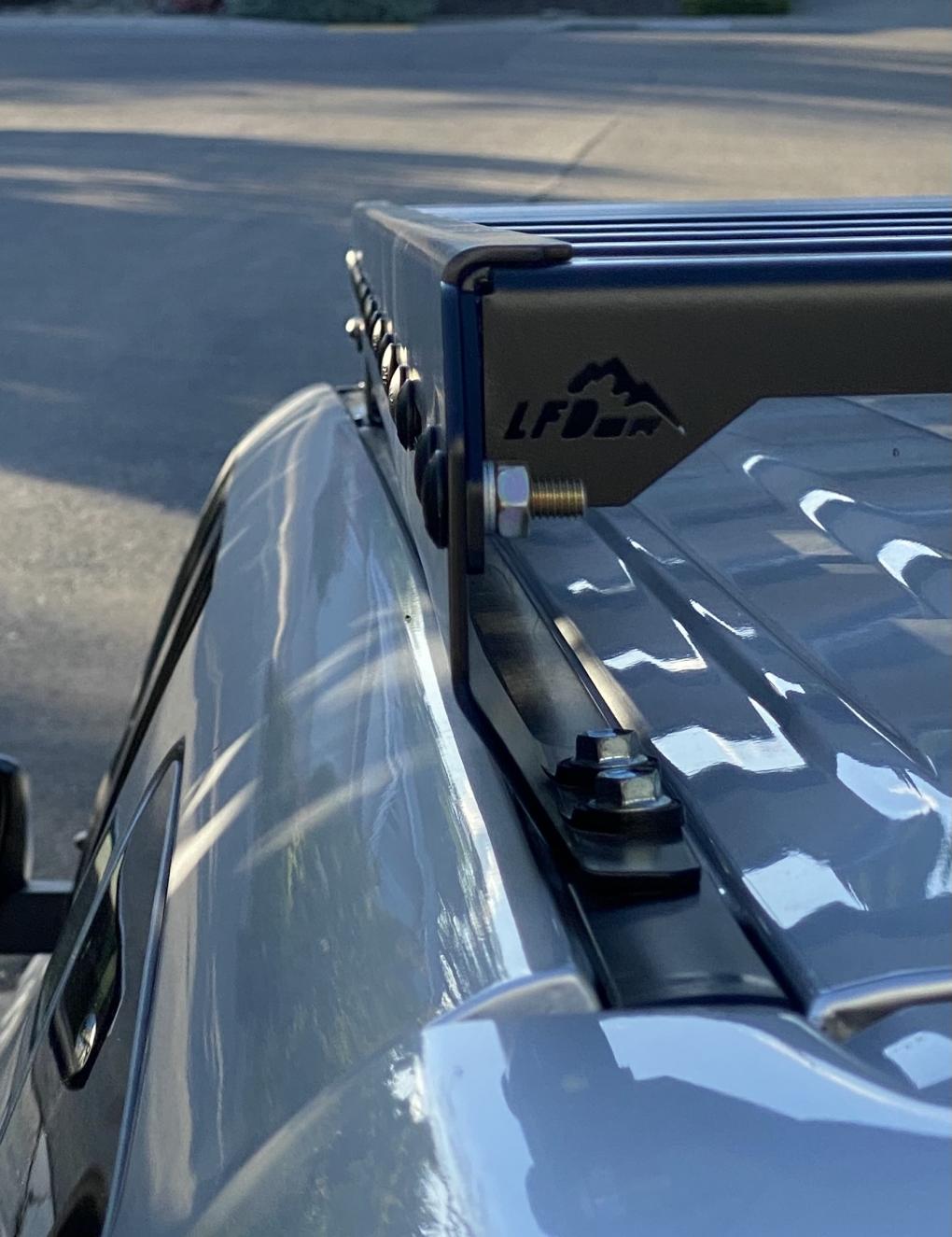

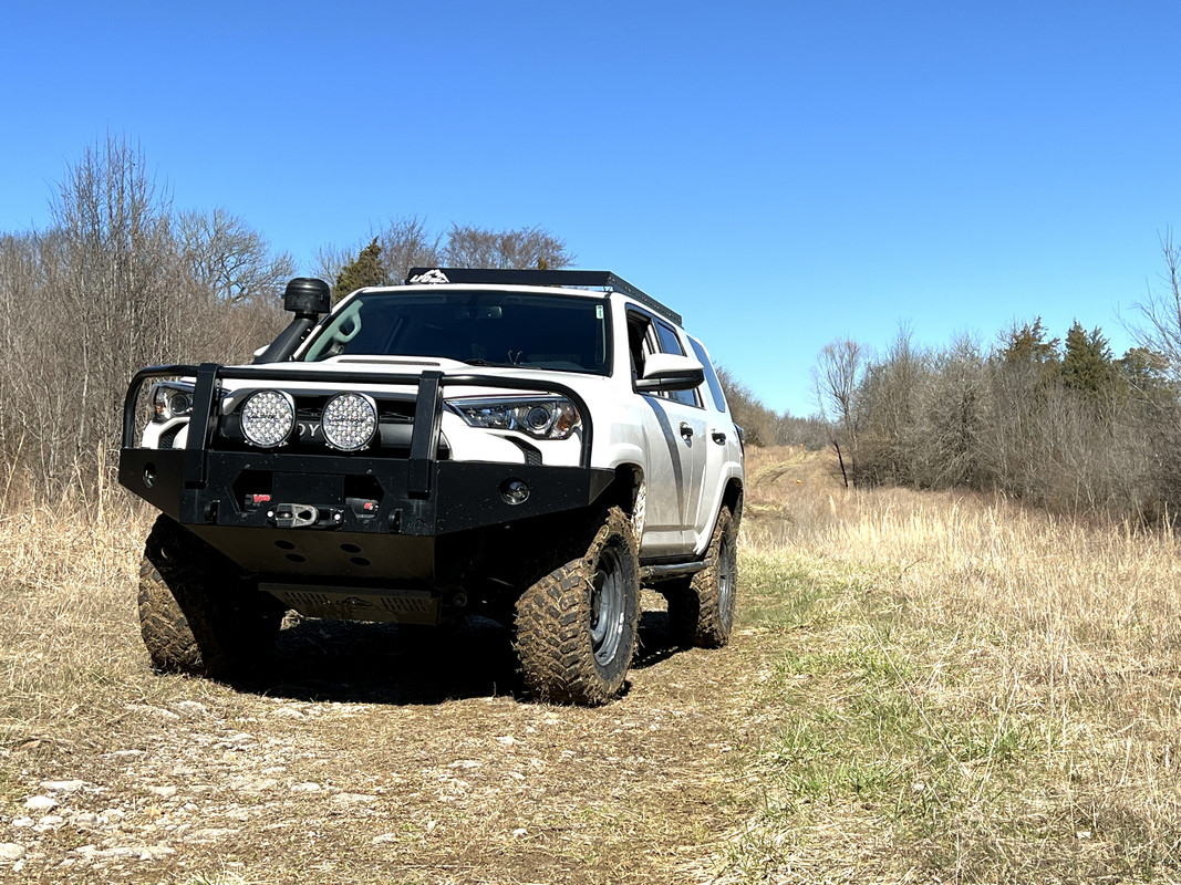

Recently added the stainless full rack to my 5th gen and so far so good. There was something slightly askew when putting on the front support feet, I should have double checked that before tightening everything down. Instead of loosening it up and trying to shift things, I made some spacers from some scrap bar stainless and it solved the issue. No noticeable wind noise until I was going over 80. Sealed the mounting points with GE 100% supreme silicon from the big box store and after a few rains there are no leaks, hope it stays that way.
As an added touch I went ahead and had paint protection film put on the roof prior to install so I don’t have to obsess about a dirty roof.
Also painted the bolt heads for a cleaner look, YMMV. The close up of the mount uses my own bolts since the spacers required something longer than was provided.
Now I’ve got a foundation to build on, thanks for a quality product and great packaging that kept everything safe in shipping.

I don’t know their entire product line but here’s a pic of the side rail of my 5th gen full rack showing part of the side rail is flat

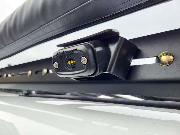

checking this thread to see if anyone has mounted lights on the sides of their LFD rack. the shape (i.e. not flat) side rails make it seem a little tricky. I fish a lot at night and could benefit from a side utility light.
We've got some bolt on handle/light mounts that just came back from paint a few days ago... working on photos as soon as the truck with them installed comes back from vacation this week :wink2:
ETA photo!
